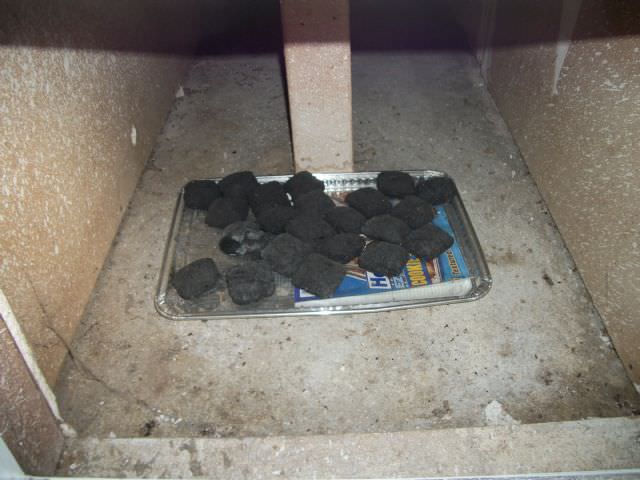

esch Posted June 25, 2010 Report Posted June 25, 2010 Why is there charcoal in air return chamber? The return grille is in the kitchen is it supposed to cut down on odors? Click to Enlarge 53.86 KB Matt
hausdok Posted June 25, 2010 Report Posted June 25, 2010 Hi, The charcoal will absorb odors but I doubt that placing a bunch of briquettes on a cookie sheet on the floor of the return will do much good. Now, if they'd gone to a fish supply store, bought a big old bag of activated charcoal and stopped off at the big orange box for some galvanized mesh and some stop strips, and then made a charcoal filter that completely covered that opening, by sandwiching a layer of charcoal between two sheets of mesh, they would probably eliminate a bunch of odor in air returning to the home through that ductwork;.....and create air side issues with the HVAC system that will probably play havock with head pressure at the HVAC system and then live to regret it later. ONE TEAM - ONE FIGHT!!! Mike
Jim Katen Posted June 25, 2010 Report Posted June 25, 2010 I've been in several houses where the sellers had coffee cans full of charcoal in each bathroom. The idea was to cut down on odors. It didn't work. - Jim Katen, Oregon
Bill Kibbel Posted June 25, 2010 Report Posted June 25, 2010 Why is there charcoal in air return chamber? The return grille is in the kitchen is it supposed to cut down on odors? I see folks trying to use charcoal to absorb moisture. What's a return vent doing in a kitchen?

Tim H Posted June 25, 2010 Report Posted June 25, 2010 Activated charcoal will adsorb many of the organics that contribute to bad odors. Activated charcoal is charcoal that has been treated with oxygen to increase the bonding sites (surface area). When certain chemicals pass over the activated charcoal they bond chemically (adsorb) to the surface of the charcoal. Charcoal briquets, obviously, are not activated. Tim
Mark P Posted June 25, 2010 Report Posted June 25, 2010 I remember a house that had charcoal in every closet in the house and under the stairs and behind the stove and in the pantry and just about every out of the way place you looked. I wondered what they were thinking, but knew whatever it was they were operating on folklore. At least they were trying, it was obvious they had very little money. It ain't easy being poor.
