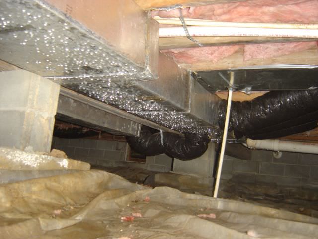

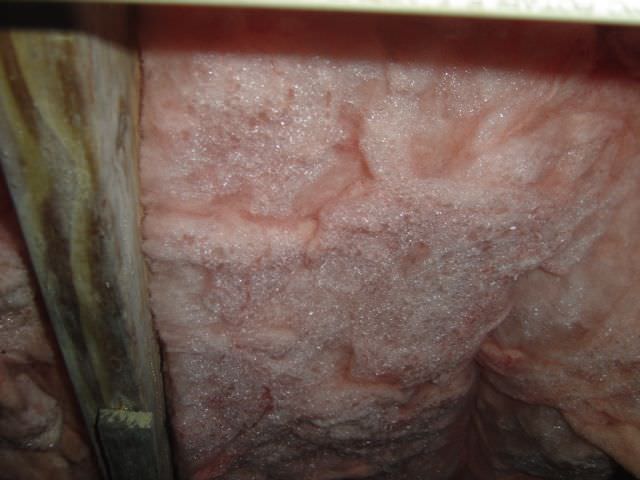

Ben H Posted June 24, 2010 Report Share Posted June 24, 2010 Need a little advice from a greybeard or two[]. The crawl in todays house had a VERY large around of moisture, but not on the ground. It was hanging from duct work and insulation. It did not smell musty either... The crawl was indeed not vented well, but in my mind something else has to be going on. I'd say roughly 75% of the insulation had water drops hanging from it. There was a little water here and there on the VB, but not what I could call a lot. Not really standing water, just a teaspoon here and there... Click to Enlarge 44.54 KB Click to Enlarge 52.47 KB Link to comment Share on other sites More sharing options...

John Kogel Posted June 24, 2010 Report Share Posted June 24, 2010 Are they pumping ice cold air thru their ducts? I believe damp air is trapped in the crawlspace, then moisture is precipitating out of the damp air onto a cooler surface. There could be a leaking duct from a clothes dryer down there. I'd check for that. Jim, you beat me to it! I would install at least two vents and put a fan on one of them. That is not something I'd ever see in my climate, so in the end, I don't have a clue. [] Link to comment Share on other sites More sharing options...
Ben H Posted June 24, 2010 Author Report Share Posted June 24, 2010 Jim: Dryer vent is OK. John: Crazy right? There are a few vents in the crawl, but this house is 3600sf, mostly on 1st floor. Pretty good size footprint. What or who would you guys punt this to? Foundation guy? Insulation guy? Both? [] Link to comment Share on other sites More sharing options...
David Meiland Posted June 24, 2010 Report Share Posted June 24, 2010 Is the a/c on and running thru those ducts? What was the temp/RH/dewpoint in the crawl? Absent a dryer vent leak or some other egregious source of warm moist air, the answer may be that the ducts need to be sealed with mastic, and probably insulated, and sources of moisture need to be controlled (how good was the ground cover, any observations on drainage around the perimeter?) Link to comment Share on other sites More sharing options...
Ben H Posted June 25, 2010 Author Report Share Posted June 25, 2010 Hey David, yeah they are running A/C through those lines. The crawl was very cool in temp vs the house/outside. I didn't find any leaking A/C vents, but there could have been some. Ground cover was actually pretty good, typical heavy mil plastic laid out. Not the greatest around the edge, but over all not bad. I just can't get over the amount of moisture, by far the most I've ever seen. Link to comment Share on other sites More sharing options...
hausdok Posted June 25, 2010 Report Share Posted June 25, 2010 Vapor diffusion, In some parts of the country crawlspace ventilation is a balancing act. In colder months you have to have plenty of vents open and air movement through the crawl to help dispel moisture buildup under the home as the humidity under the home bypasses the exterior humidity and spikes; in the warmer summer months when the humidity outside spikes you have to find a way to keep the crawl at around the same temperature/humidity as outside or you'll create your rain forest. Vapor diffusion is the process of air moving from moister to drier and from warmer to cooler. If exterior humidity in Kentucky right now is higher than what you have in the crawl, and if the interior of the home is air conditioned and the floor of the home is coolest (warm air falls, warmer air rises so the floor should be the coolest place in the home), you have warm air diving in there seeking that cold dry area under the floors. I'm guessing that the insulation isn't snug against the underside of the floor above and warm/moist exterior air is migrating into the cool place above that insulation where it's condensing to water and then drips back down through the insulation. Tell them to get a building scientist in to design a system that will keep interior crawlspace air balanced with exterior air. Check out advancedenergy.org. ONE TEAM - ONE FIGHT!!! Mike Link to comment Share on other sites More sharing options...
