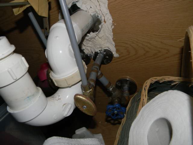

Ben H Posted May 21, 2010 Report Posted May 21, 2010 ain't talkin' about the sandwich. I couldn't get a concrete year, but was told the home was 15 years old. 95 would be the end of pb right? Click to Enlarge 39.84 KB Click to Enlarge 36.84 KB
Ben H Posted May 21, 2010 Author Report Posted May 21, 2010 My first PB home, what do you guys normally do, punt to the plumber?
Robert Jones Posted May 21, 2010 Report Posted May 21, 2010 With the failure rates and some of the stories I have read concerning PB, I would recommend to my clients that it be replaced. Here is some info that fit's right in with your 1995 home. "In 1995, two manufactures of the raw material used to make polysettled a case and agreed to a $950 million settlement. As the Judge noted...this is a minimum amount. When this money is used up, the defendants can put in more money or the case will become active again. A third manufacturer settled the case by establishing a fund that may provide a 10% reimbursement for property owners with acetal insert fittings, and a leak is not required." The claim period ended in 2009. http://www.pbpipe.com/
Ben H Posted May 21, 2010 Author Report Posted May 21, 2010 It's early, but for some reason I was thinking there is another style of plumbing that closely resembles PB, but doesn't have the break down problems. Did I dream this last night? Not PEX, but something else....
Greg Booth Posted May 21, 2010 Report Posted May 21, 2010 What I can see from your pic, looks like copper fittings were used. In my experience, most failures were with the plastic fittings, as opposed to the pipe itself. The developed replacement for PB is Pex. There are brass transition fittings to take one from PB to Pex, and they should always be used. If there are copper fittings, instead of plastic, I would call it as an item to be monitored. Further suggest when hiring trades people to work on their plumbing, they be versed in Pb/Pex installation methods.
Ben H Posted May 21, 2010 Author Report Posted May 21, 2010 I was doubting myself b/c I didn't see any writing on the stuff except a small piece that had SDR 11. From what I can find thats the tail end of PB2110 SRD11. I just didn't want to start a sh%t storm when ity wasn't called for. []
