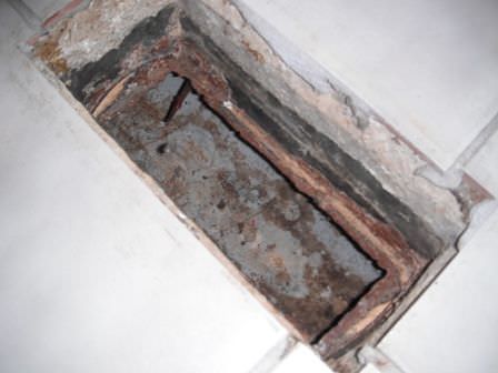

NJinspector Posted May 18, 2010 Report Share Posted May 18, 2010 Ductwork was run through the slab, and I assumed this material was Transite although I've never seen it before. Seller brought in another inspector that says the ducts are all metal and free of any asbestos. Opinions? Click to Enlarge 22.57 KB Link to comment Share on other sites More sharing options...
kurt Posted May 18, 2010 Report Share Posted May 18, 2010 Can't tell from the pic. Need a closeup. Looks like metal edges and rust from here. Transite is gray, with easily identifiably white fibers sticking out of the cement matrix where the hole is smashed for the register. Link to comment Share on other sites More sharing options...
Tom Raymond Posted May 18, 2010 Report Share Posted May 18, 2010 That looks like a metal duct to me. The insulation around it could be an ACM, but it isn't transite. Transite is a silly putty colored concrete like material with visible reinforcement fibers in it that is fashioned into ducts and vent pipes. Generally a metal 'pipe' would transition into transite to pass through a combustable plane of the building and not be completely encased in it. Tom Link to comment Share on other sites More sharing options...
