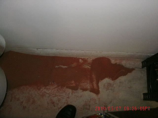

I walked into the store room and seen this and I said to myself of course, what a large ant mound.
Click to Enlarge
33.28 KB

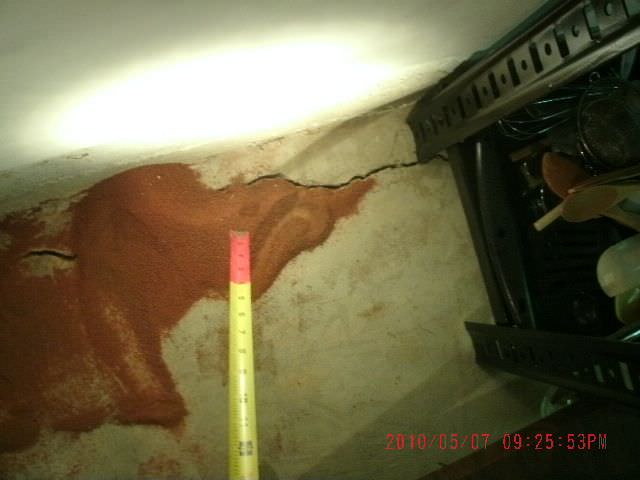

But wait I see no ants. I move some of the dirt to see if there is any kind of bug in it and there is none.
But what I find is a crack in the floor.
Click to Enlarge
37.2 KB
Click to Enlarge
29.58 KB
So the question is did some kind of pest bring the dirt up out of the crack or did man bring it in to cover the crack?

I've seen piles of ant debris that large and larger. But, as you observed, there are usually some ants or ant parts mixed in.
It's also odd that, in the first picture, the pile describes a perfectly even angle of repose. I can't imagine how ants could do that by building up the pile from below. However, I can easily imagine how it could happen by dropping the material from above.
I vote for man.

I am not so sure. If it was man, how did it get distributed so precisely on only one side of the crack in the second photo? (see the area at the top of the photo)
If it was dumped or spread in some fashion I would assume that it would be on both sides of the crack. Brought up from underneath, however, it would be easy to deposit where they chose.

Well, that's a good point. There's also the uniformity of particle size that argues in favor of the ants.
Phillip, there's nothing for it but for you to go back and watch the mound for 12 hours or so.

The dirt is the color that I see in ant beds in the drive way and I have found some inside garages and store rooms that color.
The house is on a slab.

The reason I was wondering if it was man is because of no ant parts in the dirt.
Nothing that looks like tunnels in the dirt and the crack on the exterior wall close to that area and size of the crack.

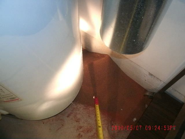

Is there any possibility that the dirt came in through the venting? The peak sees to be beneath the duct. Winds outside picking up particles that are drawn into the house?
Posted
The vent ends in the attic
