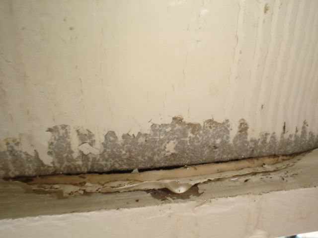

Statenmom Posted May 6, 2010 Report Share Posted May 6, 2010 What happens when the soffits and eves get wet? I have been trying my installers to fix the horrible job they did for 18months in the mean time my eves have been getting wet and going through freeze thaw. Do I need to have them replace the siding? Ohh yeah and the color is bubbling off! Link to comment Share on other sites More sharing options...

Statenmom Posted May 6, 2010 Author Report Share Posted May 6, 2010 Basically what is happening is when the replaced the drip edges they ripped up my ice sheild and rake edge and did not allow any of the shingles to over hang! So the water flows under the drip edge and under the eves and fascia board. Also they did not seal a joint between my roof and my chimney chase. I live were we get 300" of snow a year. I am trying to get you pics. Link to comment Share on other sites More sharing options...

Statenmom Posted May 7, 2010 Author Report Share Posted May 7, 2010 Here is a photo of what is happening! Does this need to be replaced or once the water problem is solved this hardie will be ok? Click to Enlarge 29.72 KB Link to comment Share on other sites More sharing options...
Brandon Whitmore Posted May 7, 2010 Report Share Posted May 7, 2010 Statenmon, Can you take an establishing shot -- that would help greatly. In my climate, I've never seen fiber cement materials become so deteriorated that they needed be replaced. Not unless there are installation errors with the product. Fiber cement does not rot, but absorbs/ holds quite a bit of water. My concern would not be with the fiber cement, but with materials behind it. It sounds like ice damming, leak, and roof issues need to be addressed, materials need to be removed for further examination of hidden components, etc. Either hire the best inspector in your area, or the best contractor you can find to go out there and determine what all needs to be done. Link to comment Share on other sites More sharing options...

Chad Fabry Posted May 7, 2010 Report Share Posted May 7, 2010 I like fibercement but it doesn't like to be saturated and frozen. It's like freezing cheese; it's still ok but it's not the same. Link to comment Share on other sites More sharing options...
