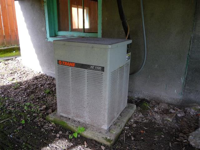

Robert Jones Posted April 29, 2010 Report Share Posted April 29, 2010 Will someone break down how to get the tonnage for the attached pic/label. It is a 14 yr old Trane AC unit. Looks tiny to me. The finished sq footage is about 1400sq ft. Thanks. Click to Enlarge 58.27 KB Click to Enlarge 64.25 KB Link to comment Share on other sites More sharing options...
Terence McCann Posted April 30, 2010 Report Share Posted April 30, 2010 The model number 018 (18.000 BTUs) looks like a 1 1/2 ton unit Rob. I agree, looks a tad small for the sf. I use a rough 600 sf per ton rule. Link to comment Share on other sites More sharing options...
Inspectorjoe Posted April 30, 2010 Report Share Posted April 30, 2010 Yes, 1.5 tons or 18,000 BTU's as shown by the 18 in the middle of the model number. You can double check (ballpark range) it against the RLA, but the formula has been changing as the efficiency has been increasing. An RLA of 8 seems about right for a unit that age. An older one of the same size would be somewhat higher, a newer unit would be somewhat lower. That would be undersized here in eastern PA, but I don't know how hot it gets in your neck of the woods. Link to comment Share on other sites More sharing options...

John Dirks Jr Posted April 30, 2010 Report Share Posted April 30, 2010 I'd rather have a unit slightly too small than one slightly too big. The smaller unit will cycle less and last longer. Usually, much longer. Link to comment Share on other sites More sharing options...
Marc Posted April 30, 2010 Report Share Posted April 30, 2010 There's the Manual J Calculation which computes heat/cool loads, but I haven't used it for many years. I just ask the customer a few questions about the past performance of their existing system in the summer (and consider it's condition) before suggesting a tonnage value for the new system. The way I see it, if the unit runs non-stop, all day long, but cools adequately under worse case conditions on the hottest day of the summer, it's the right size. Like Kurt said on another thread....different building methods interacting with new and different building materials just doesn't always yield to textbook calculations. He was referring to humidity behavior but I think it applies to heat also. I hope I quoted him right. Marc Link to comment Share on other sites More sharing options...
RSpermo Posted April 30, 2010 Report Share Posted April 30, 2010 I would be careful in calling a unit too small if I had not done Manual J calculations. You really need to address alot of factors (insulation, house siting, overhangs, windows, etc) before calling it undersized. Oversized is more of a problem especially in regards to removal of moisture. Link to comment Share on other sites More sharing options...
