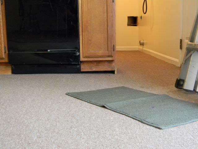

Ben H Posted April 29, 2010 Report Share Posted April 29, 2010 Yesterdays home was a head scratcher. Built in 89. Brick looked great, no patch work that was visible, no inside cracks on the walls besides a very minor one in the hall above the door. Attic looked fine. However in all four corners of the house, you can feel like you are walking up/down hill depending on which way your are walking. Some rooms you can flat out see it. The kichen cabinet just happened to be missing a piece of trim and I was able to see the slab. Click to Enlarge 42.62 KB Check out this gap! I'm gonna have to punt this one, without being able to see the concrete, it's hard to be able to get a real idea whats going on here. Any thoughts? Link to comment Share on other sites More sharing options...

Jim Baird Posted April 29, 2010 Report Share Posted April 29, 2010 Is that carpet in the kitchen? Wonder what it is covering up? Link to comment Share on other sites More sharing options...
Ben H Posted April 29, 2010 Author Report Share Posted April 29, 2010 Oh boy it gets better....Today I get a call from my client. She talked with the man who is selling the home (a builder by trade I was told) and asked about the floor. His responce: "The original owners had the floor poured that way in case of a flood, the water would run to the outer walls."[:-bigeyes I can't make this stuff up, I simply not that creative.[:-dev3] Link to comment Share on other sites More sharing options...

Greg Booth Posted April 30, 2010 Report Share Posted April 30, 2010 Marc is right! A few years ago, we installed a 16X80 single-wide on an owner-prepared site. Someone had told the owner (an electrician by trade) that he should pitch the slab slightly to "...help the drainage." Well, one-quarter inch per foot, in a run of 76 feet........ Could not believe my eyes when we arrived at the site--we had to chain the unit to both service trucks to keep it on the slab when we started to level it. LOL now, but it was far from funny at the time. Link to comment Share on other sites More sharing options...
Jim Morrison Posted April 30, 2010 Report Share Posted April 30, 2010 Chances are it wasn't intentional, but it could have been. I still say when you see something strange and potentially very bad that you can't figure out, punt. Link to comment Share on other sites More sharing options...
Ben H Posted April 30, 2010 Author Report Share Posted April 30, 2010 Seems to me if you were concerned about a flood in a home that is built in a area that has never flooded, would it not be a better idea to grade it to the center and install a drain? Either way it's out of my hands now. Punted. Link to comment Share on other sites More sharing options...
Marc Posted April 30, 2010 Report Share Posted April 30, 2010 Seems to me if you were concerned about a flood in a home that is built in a area that has never flooded, would it not be a better idea to grade it to the center and install a drain? Either way it's out of my hands now. Punted. You gotta be kidding! You're better than that. If a buyer is worried about flooding, buy elsewhere, install a pad or elevate. Marc Link to comment Share on other sites More sharing options...
