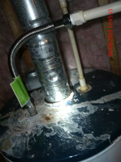

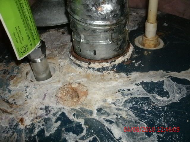

Phillip Posted April 8, 2010 Report Share Posted April 8, 2010 **** Click to Enlarge 53.16 KB Click to Enlarge 74.32 KB Click to Enlarge 49.03 KB Link to comment Share on other sites More sharing options...

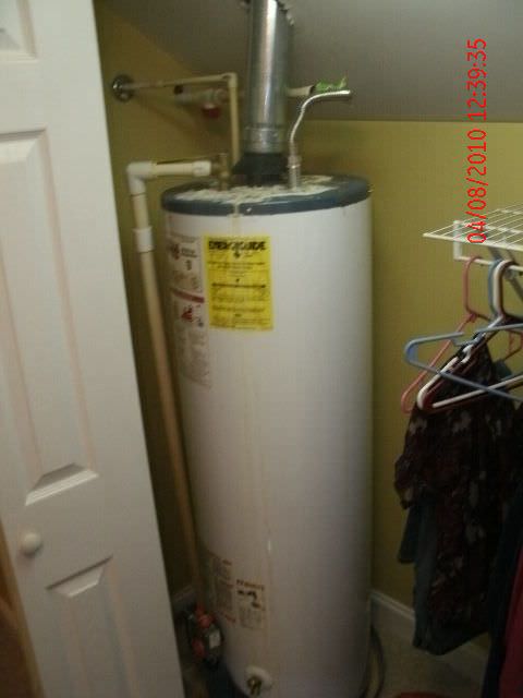

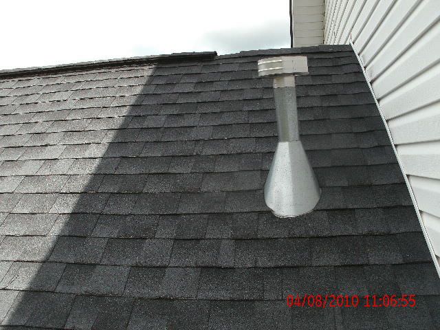

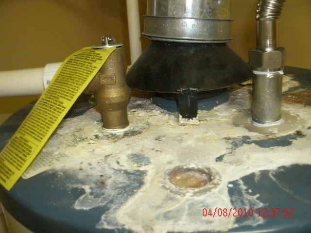

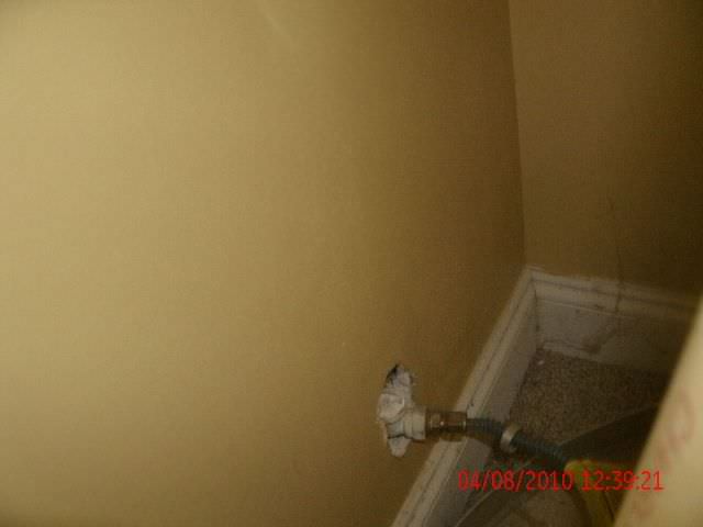

Phillip Posted April 10, 2010 Author Report Share Posted April 10, 2010 Steve, Here are a few more photo that goes along with the first photos. The water heater is in a cloths closet upstairs. Click to Enlarge 29.69 KB The shut off for the gas line is in the wall to the left of the water heater. Click to Enlarge 23.74 KB This is the vent on the roof. What do you see that wrong with this set up? Click to Enlarge 77.91 KB Link to comment Share on other sites More sharing options...
Stephen D. Gazo Posted April 10, 2010 Report Share Posted April 10, 2010 Okay, that B vent is way to close to the gable end siding, should be higher and at least 6' away. The shut off for the fuel is located in a dangerous location for emergency shut-offs. Having the H20 installed in the clothes closet is a no no for fresh air, its going to starve and then venting will most likey come back inside. No sign of CO detector in there and that shirt needs ironing,badly. No doubt there is more, please enlighten me, havnt touched gas since 1985 when it was new.... Link to comment Share on other sites More sharing options...
Phillip Posted April 10, 2010 Author Report Share Posted April 10, 2010 There is no storm collar on the roof flashing and the shingles are installed on top of the flashing at the bottom where the bottom/lower area of the flashing should be on top of the shingles. Link to comment Share on other sites More sharing options...
