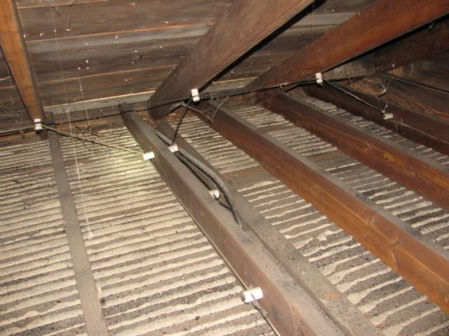

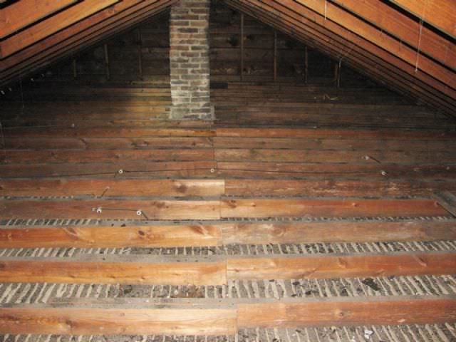

Mark P Posted March 31, 2010 Report Share Posted March 31, 2010 I know many of us have seen this before, but it just blows my mind that for 90 years, no one bothered to place insulation in this attic. Granted in 1920 when this house was built coal was cheap, people were not as energy savvy as they are today. But what about the people that lived here in the 70ââ¬â¢s 80ââ¬â¢s, last year? Didnââ¬â¢t anyone ever wonder why their bills were so high, or why the house was so cold? Didnââ¬â¢t anyone ever go into the attic and say has there is no insulation up here. We know you canââ¬â¢t bury K&T under insulation, but I donââ¬â¢t think that is why insulation was not added. I just think the house has a long history of dumb owners. Click to Enlarge 58.44 KB Click to Enlarge 61.44 KB Link to comment Share on other sites More sharing options...

kurt Posted April 1, 2010 Report Share Posted April 1, 2010 I see this often. Every 2 flat in the city has about 2" of matted down glass, or nothing. Most of the old balloon framers have nothing. The one's with roof vents have huge heating bills. The one's that don't have roof vents aren't as bad as one might imagine. Go figure........ Link to comment Share on other sites More sharing options...
Terence McCann Posted April 1, 2010 Report Share Posted April 1, 2010 You shouldn't cover K&T with insulation. Link to comment Share on other sites More sharing options...
kurt Posted April 1, 2010 Report Share Posted April 1, 2010 You shouldn't cover K&T with insulation. Has anyone ever seen K&T that wasn't covered with insulation? (other than the pic that started this thread.....) I don't think I ever have. Link to comment Share on other sites More sharing options...
Neal Lewis Posted April 1, 2010 Report Share Posted April 1, 2010 Yeah, I see it all the time without insulation. In the basement... Link to comment Share on other sites More sharing options...
Terence McCann Posted April 1, 2010 Report Share Posted April 1, 2010 You shouldn't cover K&T with insulation. Has anyone ever seen K&T that wasn't covered with insulation? (other than the pic that started this thread.....) I don't think I ever have. No, me neither (although, by the book, it shouldn't be buried). Link to comment Share on other sites More sharing options...
Marc Posted April 1, 2010 Report Share Posted April 1, 2010 You'll run into uninsulated attics with K & T wiring fairly often where I'm at. The winters are not so cold and long here, so insulation isn't as important. Marc Link to comment Share on other sites More sharing options...
AHI in AR Posted April 2, 2010 Report Share Posted April 2, 2010 You'll run into uninsulated attics with K & T wiring fairly often where I'm at. The winters are not so cold and long here, so insulation isn't as important. Marc I would respectfully point out that it's easy to diminish the importance of insulation in attics in hot climates in the summer time. A lot of people get into the habit of thinking that heat will only rise. That's not seeing the whole picture. While hot AIR rises, heat as a substance will always seek equilibrium; it will always move from an area of greater concentration to an area of lesser concentration. Hot summertime attic air will affect temps in the living areas below it. Insulating the attic is useful in hot climates also. Link to comment Share on other sites More sharing options...
