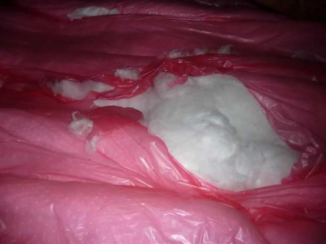

gtblum Posted April 1, 2010 Report Share Posted April 1, 2010 Here's one I found this morning. Felt more like soft cotton than fiberglass. It's not as course as the white glass sound proofing insulation. Anyone know what flavor this is? Click to Enlarge 29.06 KB Link to comment Share on other sites More sharing options...
Bill Kibbel Posted April 1, 2010 Report Share Posted April 1, 2010 It's Miraflex by Owens Corning. It was discontinued several years ago. It's made from fiberglass, but the fibers were twisted to make it "cottony soft". It was also encapsulated in a perforated polyethylene jacket. Link to comment Share on other sites More sharing options...

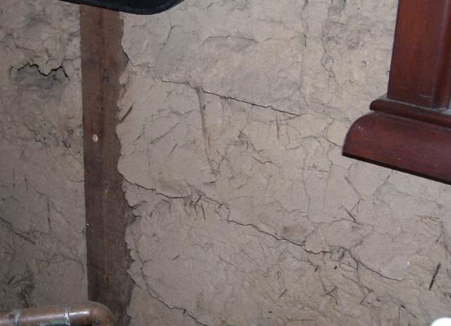

Bill Kibbel Posted April 2, 2010 Report Share Posted April 2, 2010 Here's a spot where the wall insulation was exposed in the house I inspected yesterday. Click to Enlarge 46.2 KB Link to comment Share on other sites More sharing options...
kurt Posted April 2, 2010 Report Share Posted April 2, 2010 What is it? Looks like straw fiber in plaster. Link to comment Share on other sites More sharing options...
Bill Kibbel Posted April 2, 2010 Report Share Posted April 2, 2010 Mud and rye straw. Installed exactly 240 years ago. Link to comment Share on other sites More sharing options...
Marc Posted April 2, 2010 Report Share Posted April 2, 2010 Whitewashed? Marc Link to comment Share on other sites More sharing options...
Bill Kibbel Posted April 2, 2010 Report Share Posted April 2, 2010 No, no lime - just the light brown color of dried mud from that area of NJ. You can see the formed shape from the clapboards that were removed from that wall. Link to comment Share on other sites More sharing options...
