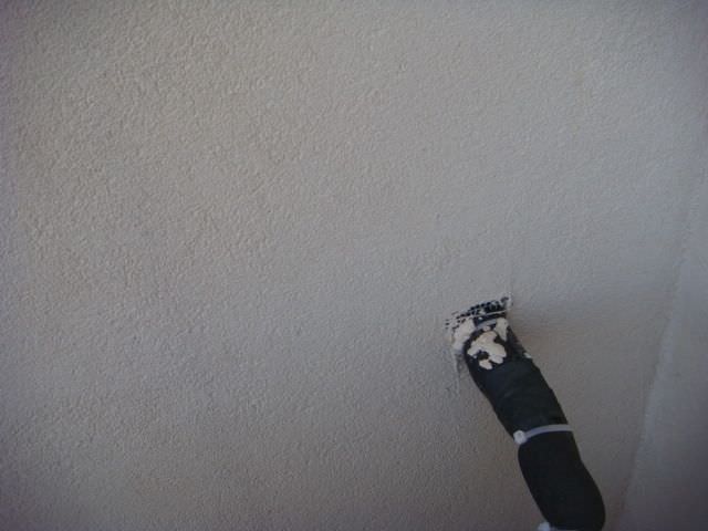

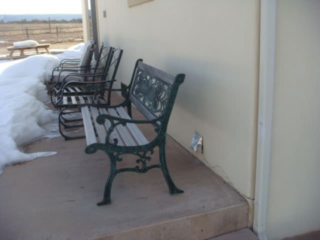

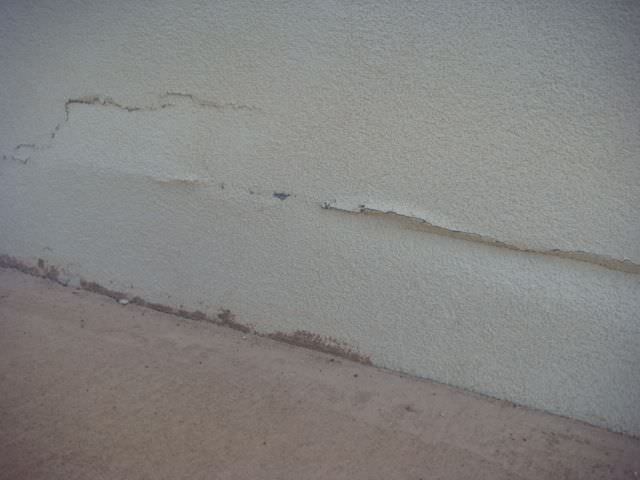

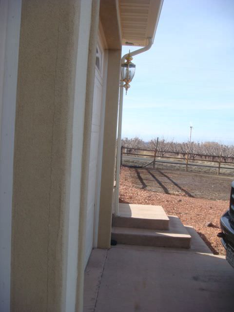

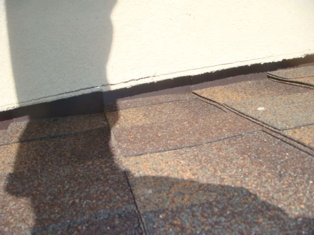

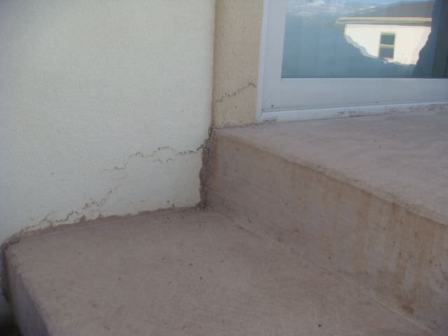

mridgeelk Posted March 18, 2010 Report Share Posted March 18, 2010 This home has an EIFS exterior with a lot of cracking. I can't find an EIFS inspector online. There are plenty on the Front Range but none on the Western Slope. Any suggestions? Click to Enlarge 26.14 KB Click to Enlarge 30.62 KB Click to Enlarge 34.93 KB Click to Enlarge 51.02 KB Click to Enlarge 38.49 KB Click to Enlarge 65.31 KB Click to Enlarge 40.61 KB Link to comment Share on other sites More sharing options...

hausdok Posted March 18, 2010 Report Share Posted March 18, 2010 You really don't need an EIFS inspector to comment about that mess. EIFS isn't supposed to be behind concrete and needs to terminate at least two inches above hardscaping. The bottom edges and ends and even that hole need to be back-wrapped with embedded mesh and they need to have termination bead material and a flexible joint around windows and doors. Bet you a case of Martinelli's apple cider there're serious rot issues in the base of those exterior walls where that stuff has cracked. ONE TEAM - ONE FIGHT!!! Mike Link to comment Share on other sites More sharing options...

Scottpat Posted March 18, 2010 Report Share Posted March 18, 2010 Your pictures show a good amount of compression cracking and also what looks like movement of the flatwork or the foundation of the home! I don't see any isolation joints, expansion joints or sealants and backer rod around any of the penetrations. The rain gutters are attached improperly to the EIFS wall. The base of the walls are not back-wrapped properly or at all. OK, the above list should be enough to get the ball rolling. Add, that they need to have a qualified EIFS contractor make the appropriate repairs and corrections to the manufacturers guidelines and standards. Repairs and corrections like this can and will involved removal of sections of the EIFS in order to make repairs to any underlying or hidden damage to the structure. This should be about you need to add to your report. Note: Whenever you see cracks around the sillplate or around this area, you need to look for rot. Many times water can seep in and rot the sillplate and this can cause the structure to settle and this is seen in the way of the compression cracks, like you have in the photos. Compression cracks can also be caused by the lack of a proper installation of the EIFS on a home, most often this is seen with a multi level home. Link to comment Share on other sites More sharing options...
Marc Posted March 18, 2010 Report Share Posted March 18, 2010 I'm with Scott with one exception: Cracked or improperly installed EIFS should be replaced in it's entirety all the way to the expansion joint (not reliefs). If the list of errors committed by this adventurous installer include no expansion joints, replace the entire contiguous installation. You cannot properly patch polymer based imitation stucco. Marc Link to comment Share on other sites More sharing options...
