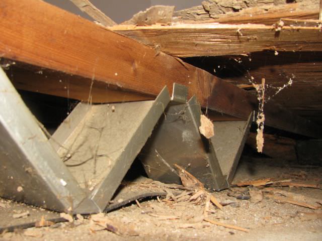

Mark P Posted March 3, 2010 Report Share Posted March 3, 2010 1st time Iââ¬â¢ve seen this system. The house has a slab foundation, but the floors are elevated about 4 - 6 inches. The subflooring rests on 2x4 that lay flat on top of metal frames on top of the slab. Or just look at the picture and you can figure it out. The duct work is under the floors. The termites had done so much damage I just kicked a hole through the ½ plywood subfloor to see what was below. HUD forclosure. The termites were even in the attic. Does anyone know a name for this system or know anything about it? Click to Enlarge 57.85 KB Click to Enlarge 56.25 KB Link to comment Share on other sites More sharing options...

Scottpat Posted March 3, 2010 Report Share Posted March 3, 2010 I have never seen that either in a home and I'm from an area that a good number of the homes are on slab foundations. It kind of looks like something you would see in a commercial building so that electrical, phone, computer and air ducts can be run without tearing things up. Very strange..... Link to comment Share on other sites More sharing options...
Rocon Posted March 4, 2010 Report Share Posted March 4, 2010 I have never seen this system before however In the mid 90ââ¬â¢s there were several attempts in residential construction to insulate and isolate the basement floors (almost like a rain screen wall) the interstitial space is a drainage area. You could use a system like this in homes where they would expect possible high water table and light flooding of the slab. The slabs would have localized depressions and drains located throughout the basement allowing incidental moisture to drain. One system I saw in Fine Homebuilding magazine had layers of XPS foam laid on the slab for insulation. The OSB was then fastened through the foam to the slab. You could supposedly even lay hardwood flooring over the OSB successfully. There are several products still on the market one with the textured plastic material you would find on Miradrain instead of having the geo fabric they would laminate it to 2ââ¬â¢ by 2ââ¬â¢ tongue and groove OSB of all things. They have obvious problems with getting too much water into the system and trapping water between the OSB and the plastic liner. All of these systems have the basic flaw of dealing with symptoms instead of preventing the water in the first place. This one also has a rat problem. Link to comment Share on other sites More sharing options...

Tim Maxwell Posted March 4, 2010 Report Share Posted March 4, 2010 I've seen it once, or should say I've felt it once. Slab home but you could tell when you walked on the main level hardwood floors that it was not sitting on the slab. The builder was at the house and said that he framed the floor up off the slab to be able to use real hardwoods. Adding rosin paper over the slab surface first to help hold down any moisture. Other than the one time I have heard of it being done in a basement for the same reason, to add real hardwood flooring. It is odd and not something I would consider. Link to comment Share on other sites More sharing options...
Mark P Posted March 4, 2010 Author Report Share Posted March 4, 2010 While we are not to far from the Mississippi, this house is above the bluffs and well out of the flood plane. I have seen house in the flood zone that have flow through basements / crawlspaces, but these are often 6+ feet high. There are opening for water to flow through / under the house and when the flood is over they can just go down and hose the area out and collect the dead fish. This house is nothing like that. I'll ask they guy who is going to flip it to call me when he starts ripping up the rotted floors and try to get some more pics with the subfloor removed. I was just wondering if there is a name to the system. Interesting for sure. If the floors had not been so termite eaten that I could just rip it apart I would have told him there was a crawlspace with no access and no vents. Link to comment Share on other sites More sharing options...
