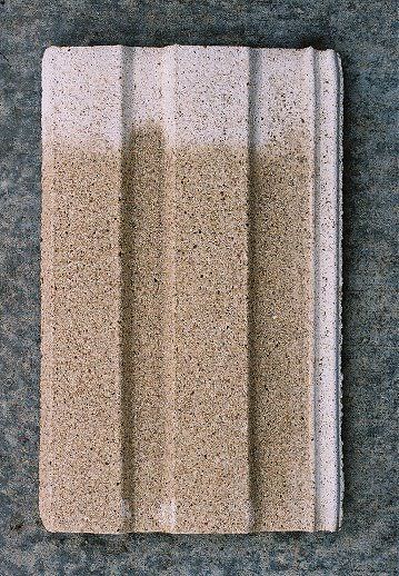

Bill Kibbel Posted April 26, 2010 Report Posted April 26, 2010 Im just assuming they are not concrete as the age does not fit. I regularly come across concrete roofs original to buildings built between 1910 and the late 1930s. A large majority are the French style tile. Click to Enlarge 67.97 KB They've all had completely exposed aggregate. It's usually large-grain coarse sand or really small stream pebbles. Some cracked, broken, loose, tar patched and missing tiles needed replacement, but I've never had a concern that the entire roof system is going to fail anytime soon. The only major issue is really cosmetic - the wear after 80-100 years has significantly eroded the original surface pigments. Click to Enlarge 88.69 KB
thomop Posted April 26, 2010 Report Posted April 26, 2010 Originally posted by thomop Im just assuming they are not concrete as the age does not fit. I regularly come across concrete roofs original to buildings built between 1910 and the late 1930s. A large majority are the French style tile. These tiles in picture are commonly know as Atlas tiles here. The were pretty common here around 1930s for the their cost effectiveness. They are/were a very weak and brittle tile. Often not worth restoring.
