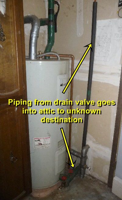

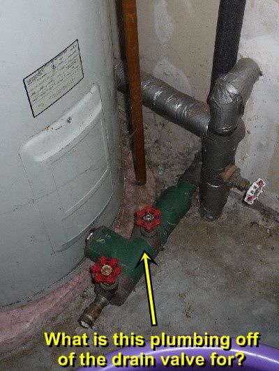

Richard Moore Posted February 28, 2010 Report Posted February 28, 2010 Your guess is as good as mine. [:-bigeyes This plumbing from the drain valve (20 year old water heater) went into the attic on this rambler, but I couldn't see where it went from there. No circ pump if that's anyone's guess. I think it may have gone to the laundry closet, but no idea why they would take it from the drain valve. Click to Enlarge 50.08 KB Click to Enlarge 54.32 KB Then there was the cold water feed to the water heater. A stop valve either side of the tee but none that would actually allow the water heater to be isolated for change-out and leave cold water to the house. Click to Enlarge 57.01 KB Maybe that is what this in the crawl is for... Click to Enlarge 42.72 KB I'm recommending the new water heater be installed by a licensed plumber who can figure out this mess. I'm thinking the water-heater-only guys would be as confused as I was.
Garet Posted February 28, 2010 Report Posted February 28, 2010 Are the plumbing supply lines run in the attic? If so it may be a gravity hot water circulation system (no pump involved). I'm considering installing one on my own house.
hausdok Posted February 28, 2010 Report Posted February 28, 2010 I think it's someone's homemade tempering system and the upper valve on the inlet line controls how much cold water flows to the hot side somewhere in the house. I think the line at the bottom is functioning like a gravity loop. the hot water rises, like it does in a hot water system and as the water up at the top cools it returns to the water heater via that doohickey installed where the drain sillcock should be. ONE TEAM - ONE FIGHT!!! Mike (Ah, I see that Garet and I had the same thought.)
Richard Moore Posted February 28, 2010 Author Report Posted February 28, 2010 Are the plumbing supply lines run in the attic? If so it may be a gravity hot water circulation system (no pump involved). I'm considering installing one on my own house. Yes, at least some of them. Let's assume the house was plumbed for return to the tank, do you think there would be enough convection flow for that to be effective for a rambler with the bathrooms at the other end of the home from the water heater? I have my doubts! There sure wasn't "instant" hot water at those bathrooms. Of course, the valve may have been closed. I was too busy scratching my head to bother trying it. "Homemade tempering system"...I guess I'd have to ask why? Home was plain Jane 90's, 3 Br 1¾ Ba, apart from this set-up. Wouldn't it have been simpler to install a tempered tub/shower faucet system at the bathroom if they really needed it?
John Dirks Jr Posted February 28, 2010 Report Posted February 28, 2010 This is a wild stab that would leave you wondering more but here goes. Could the attic piping be somehow connected to the rain gutter system? Maybe it's some idea of how to capture rain water?
John Ghent Posted February 28, 2010 Report Posted February 28, 2010 Water can't flow uphill. Wish it could. The device on the bottom looks like a flow control from a hydronic system and (pic not clear) as mike said it would make sense to limit the flow back from a tempering system set up this way.

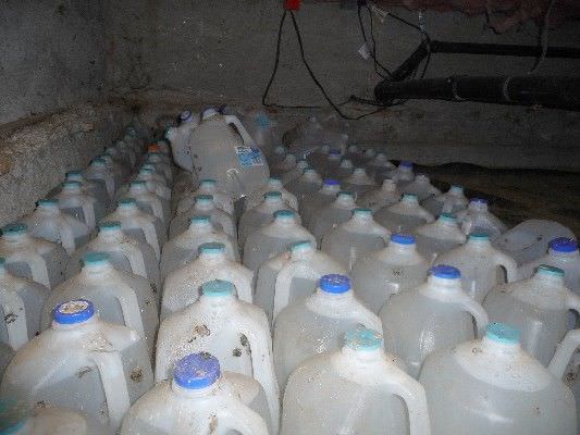

Tim Maxwell Posted February 28, 2010 Report Posted February 28, 2010 the water jugs in the crawl are left over from Y2K......don't drink it...
fqp25 Posted February 28, 2010 Report Posted February 28, 2010 Plumbed for future PV Solar panels???? Frank
Ben H Posted February 28, 2010 Report Posted February 28, 2010 the water jugs in the crawl are left over from Y2K......don't drink it... Or prep for 2012...[:-eyebrow
Jerry Lozier Posted March 1, 2010 Report Posted March 1, 2010 the water jugs in the crawl are left over from Y2K......don't drink it... Or prep for 2012...[:-eyebrow good point.... plenty of water for those tea bags in 2012??

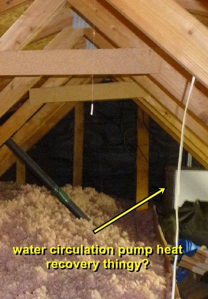

Richard Moore Posted March 3, 2010 Author Report Posted March 3, 2010 OK...I heard from the agent today. I'm not sure this makes any sense, and it is secondhand, but according to her the seller, who wasn't the one who originally installed this, says it is some type of circulation system to "use the hot air in the attic to help heat the water". He also said that the "pump" was in plain view in the attic. I'm guessing he meant this white box thing that was buried behind about 12 feet of junk stored in front of it. Click to Enlarge 56.97 KB Nothing I've ever seen before. Just looked like more "stuff" to me. Oh, and it also turns out that he discovered I'm not "ASHI certified" and, therefore, supposedly unqualified to suggest my client even ask him about this. [:-banghea
barlyhop Posted March 3, 2010 Report Posted March 3, 2010 I'm now convinced that this was a solar hot water set-up at some point in time. Copyright: Solar Developement, Inc. Florida Download Attachment: solar1.pdf 18.08 KB
Richard Moore Posted March 3, 2010 Author Report Posted March 3, 2010 I'm now convinced that this was a solar hot water set-up at some point in time. Copyright: Solar Developement, Inc. Florida Download Attachment: solar1.pdf 18.08 KB I don't think so. Along with being the original, 20-year old water heater, it looked to be the original roofing and had no signs of anything ever being mounted on it. But...who knows? It is possible they planned for one and never installed it.
barlyhop Posted March 3, 2010 Report Posted March 3, 2010 How warm can an attic get in Seattle? I would also doubt the efficiency of solar power in Seattle as well?? Perhaps that is why the system was abandoned?
Jim Katen Posted March 4, 2010 Report Posted March 4, 2010 How warm can an attic get in Seattle? I would also doubt the efficiency of solar power in Seattle as well?? Perhaps that is why the system was abandoned? Well, if it's anything like Portland, a few hours to the south, it can get up to 180 degees. Solar water and PV panels do very well here as well, even on overcast days. -Jim Katen, Oregon
