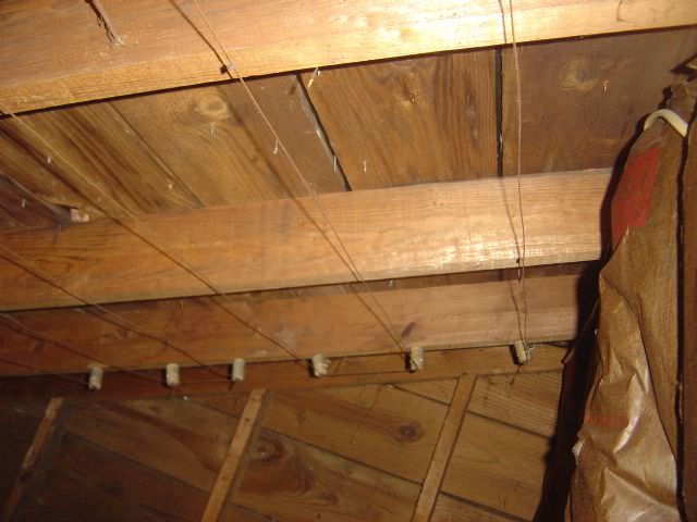

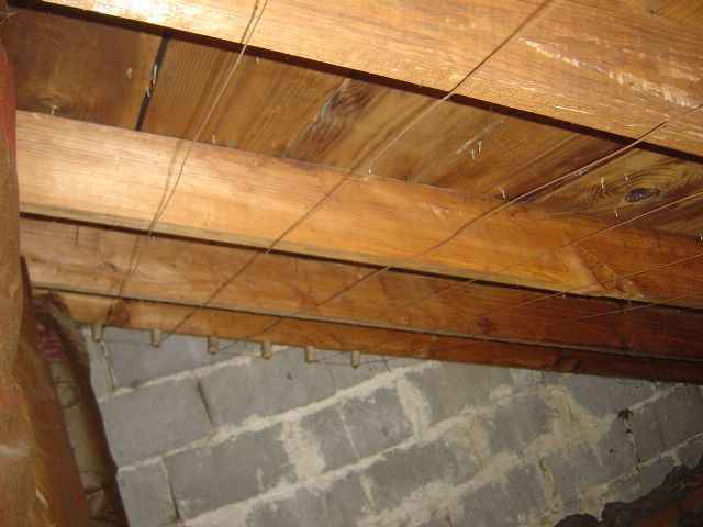

blazenut Posted February 27, 2010 Report Share Posted February 27, 2010 I inspected a home today that was around 80 years old. I assumed that i would run into k and t somewhere in the home and sure enough i did. I did however see something that i never saw before, and i cant figure out why this would be done (see below pictures). A live feed of knob and tube came into this section of a side attic and simply zig zagged back and forth, un-sheathed (?), and just terminated at the end of the zig zag. Why would this be done? Like i said, my continuity tester read that it was live. Thanks. Click to Enlarge 48.19 KB Click to Enlarge 50.23 KB Link to comment Share on other sites More sharing options...

blazenut Posted February 27, 2010 Author Report Share Posted February 27, 2010 It was only a single wire than ran back and forth, when it passed through the first ceramic housing it went from being fabric sheated to bare copper. I thought of it being an antenna but would that show a possive continuity reading for an antenna? The wire came up from never never land (from an unknown area). Link to comment Share on other sites More sharing options...
Jim Katen Posted February 27, 2010 Report Share Posted February 27, 2010 It was only a single wire than ran back and forth, when it passed through the first ceramic housing it went from being fabric sheated to bare copper. I thought of it being an antenna but would that show a possive continuity reading for an antenna? The wire came up from never never land (from an unknown area). It's a radio antenna. Extremely common (in my area you're nearly guaranteed to find it) in houses from the 30s, 40s, & early 50s. As for your "continuity" tester, what exactly are you talking about? A continuity tester has a small battery in it and is used to show continuity of a wire, not the presence of voltage, as you seem to be implying. Are you sure you weren't using a non-contact voltage detector? If so, those things give false positive readings all the time and false negative readings every so often. Never, and I mean never, trust one in a critical application. In a situation like this one, in particular, a volt stick is almost always going to show voltage in the wire even if you can see both ends of the wires dangling in the air. - Jim Katen, Oregon Link to comment Share on other sites More sharing options...

hausdok Posted February 28, 2010 Report Share Posted February 28, 2010 Hi, I've had a volt stick detect voltage in old radio antenna when the antenna passed near some live wiring and picked up the field of the electrical wire. Once, I moved the NM away from the antenna (It wasn't secured anyway) and the volt stick stopped indicating voltage on the antenna. ONE TEAM - ONE FIGHT!!! Mike Link to comment Share on other sites More sharing options...
