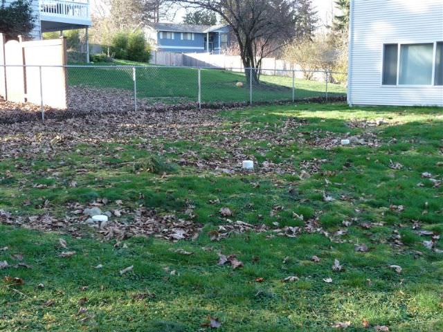

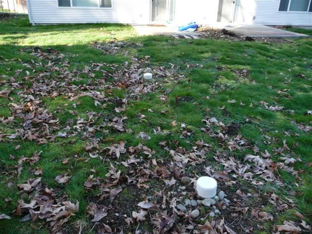

Robert Jones Posted February 19, 2010 Report Share Posted February 19, 2010 I am not sure if I have placed this in the right forum but... I am curious as to what these 3 white pipes might be for. The duplex is on a septic system which is located opposite of these pipes. The caps did not come off. Any ideas? Click to Enlarge 93.07 KB Click to Enlarge 95.49 KB Link to comment Share on other sites More sharing options...
Bill Kibbel Posted February 19, 2010 Report Share Posted February 19, 2010 I've seen many that are inspection pipes. Maybe one's over the inlet baffle, one's over the cross-over baffle and one's over the outlet baffle. Link to comment Share on other sites More sharing options...
robert1966 Posted July 30, 2010 Report Share Posted July 30, 2010 I have seen these also and they were for inspection or system monitoring, but the caps could be removed. Link to comment Share on other sites More sharing options...
Tom Raymond Posted July 30, 2010 Report Share Posted July 30, 2010 Until I dug mine up and shortened them, I removed the caps nearly every time I mowed the lawn. Link to comment Share on other sites More sharing options...
Lambert Posted September 23, 2010 Report Share Posted September 23, 2010 Hi I have a similar system in my house and these white pipes are used for draining out water .The white caps can be unplugged and we can inspect wheather the flowing is going smoothly. Link to comment Share on other sites More sharing options...
hausdok Posted September 23, 2010 Report Share Posted September 23, 2010 Hi Robert, I think Bill probably has it. They probably will come off...with a lot of difficulty. I've run across them a few times and the caps felt like they were a press fit. Once I got them to move about a quarter of an inch they slid right off. My nose told me the rest. Where are they in relation to the house? Uphill, downhill, on the same plane? If they were uphill, which would be weird for a septic system without a pump setup, they might be cleanouts for a curtain drain system. Had one of those the other day. Wish I'd taken pictures of it. ONE TEAM - ONE FIGHT!!! Mike Link to comment Share on other sites More sharing options...
