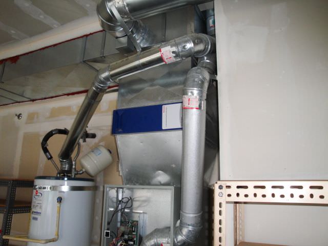

randynavarro Posted February 14, 2010 Report Posted February 14, 2010 Does this water heater vent enter the stack above the furnace or below it? It's not a trick question or a test. Click to Enlarge 41.33 KB Click to Enlarge 34.16 KB

Ben H Posted February 14, 2010 Report Posted February 14, 2010 OK I'll bite. Over, but why ask? Looks pretty typical around here. I was under the impression that as long as a "y" is used (not a "t") to connect the two flues together is was ok. Not ideal, but ok.
randynavarro Posted February 14, 2010 Author Report Posted February 14, 2010 OK I'll bite. Over, but why ask? Looks pretty typical around here. I was under the impression that as long as a "y" is used (not a "t") to connect the two flues together is was ok. Not ideal, but ok. Not asking for bites or trying to lure anybody. I was pretty clear; it's not a trick question. The furnace is entering the leg of the Y. Looking at that configuration, the furnace flue gas is entering the main stack after or above the water heater, no? Typically, the furnace would be connected to the inlet of the Y and the water heater connected to the leg. Maybe I'm over-thinking. . .the report is off with not a mention. From a practical standpoint, I don't think anything could happen. I've been wrong before. . . .
Phillip Posted February 14, 2010 Report Posted February 14, 2010 To my understanding the furnace should enter below the water heater. The bigger flue should be on the bottom (1st in) and the smaller flue connects above it. If the flues are the same size the larger BTU unit connects to the bottom. I may not be seeing the photos as you seen it on site.
Jim Katen Posted February 14, 2010 Report Posted February 14, 2010 . . . The furnace is entering the leg of the Y. Looking at that configuration, the furnace flue gas is entering the main stack after or above the water heater, no? They're entering at exactly the same spot. The water heater gases are moving in a straight line and the furnace gases alter course by 45 degrees once they enter the wye. Typically, the furnace would be connected to the inlet of the Y and the water heater connected to the leg. Maybe I'm over-thinking. . .the report is off with not a mention. From a practical standpoint, I don't think anything could happen. I've been wrong before. . . . I don't see an issue. Neither is really entering above the other, they're coming together at the wye. If someone wanted to press the issue, yes, the lower BTU appliance should enter the vent above the higher BTU appliance. In this case, I couldn't come up with a reason why it would make a difference, though. - Jim Katen, Oregon
