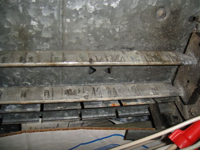

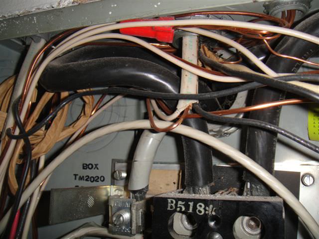

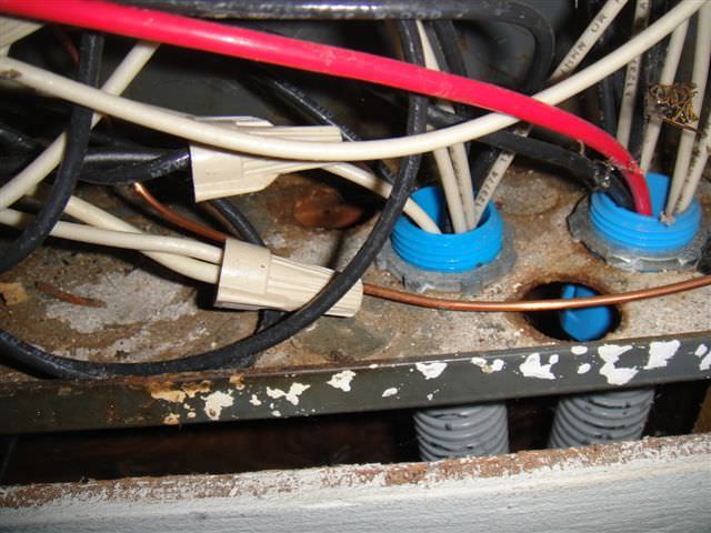

CHI Posted February 11, 2010 Report Share Posted February 11, 2010 Inspected a home the other day that was built in 1960. It had two panels, one a Zinsco that was still live, but had been gutted and now used as a junction box of sorts. There were many concerns noted: Nicked neutral wire Missing knock out covers The ground wire was too short and a white wire (may be confused with a neutral) was connected to extend the ground. Obsolete wires that were exposed in the panel. The service entrance lug to the Zinsco panel had corroded. The wiring was a general mess. I called all of the above and recommended further evaluation and repairs. I have never seen this type of installation with two panels. I don't understand why someone would leave the Zinsco in place. Come to find out the repairs had been done by a local engineering firm and was disputing the findings. The seller has had three electricians come through and have all said the way the panels are installed is ok, however made a few of the repairs. In 5 years I have not seen this type of installation. The sellers electricians say this is very common and don't have a problem with it. I get that, I just don't understand why anyone would leave the panel and not just get rid of it and replace it with the new one. The panel cover of the Zinsco showed signs of a breaker that had either gotten hot or exploded as well. Click to Enlarge 64.08 KB Click to Enlarge 67.69 KB Click to Enlarge 58.64 KB Click to Enlarge 59.5 KB Link to comment Share on other sites More sharing options...
Marc Posted February 11, 2010 Report Share Posted February 11, 2010 A white conductor should not be used as an equipment grounding conductor and the unused knockouts should have a plug on them. I don't see much in the way of significant findings beyond these two mentions. The issue that you see might be a result of the differences between an idealistic view and a practical view. Something more substantial might win you the case, such as aluminum branch circuit conductors, ungrounded branch circuits, an electrical service entrance with an ampacity that is no longer adequate for the loads served, an insufficient number of general purpose outlets, a lack of electrical service to some countertop surfaces, etc. At 50 years old, there should be something, somewhere that you can throw at them. Marc Link to comment Share on other sites More sharing options...
Tom Raymond Posted February 11, 2010 Report Share Posted February 11, 2010 Are those bus bars live? I'm guessing they are or the cardboard shields wouldn't be there. That's a mess, I can't imagine an engineer taking credit for that[:-bigeyes I wouldn't change any of those recommendations until they provide proof that it was permitted and inspected. Tom Link to comment Share on other sites More sharing options...
hausdok Posted February 11, 2010 Report Share Posted February 11, 2010 If those are two hot SEC's connected to those corroded lugs at the top of that old Zinsco box, then those are live bars and that's one very dangerous box to have accessible. Hope they had the cover screwed on tight so the uninitiated can't open it, reach inside to brush that residue away and get cooked like a Jalapeno on a stick. OT - OF!!! M. Link to comment Share on other sites More sharing options...

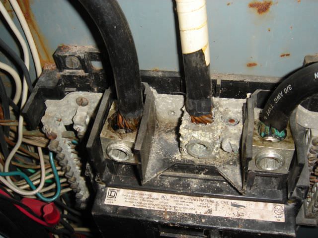

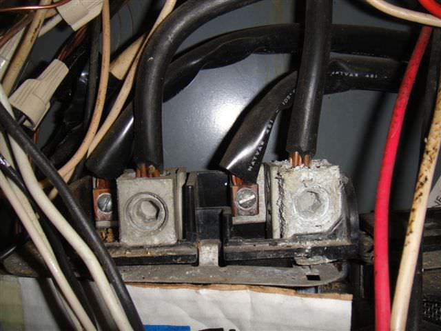

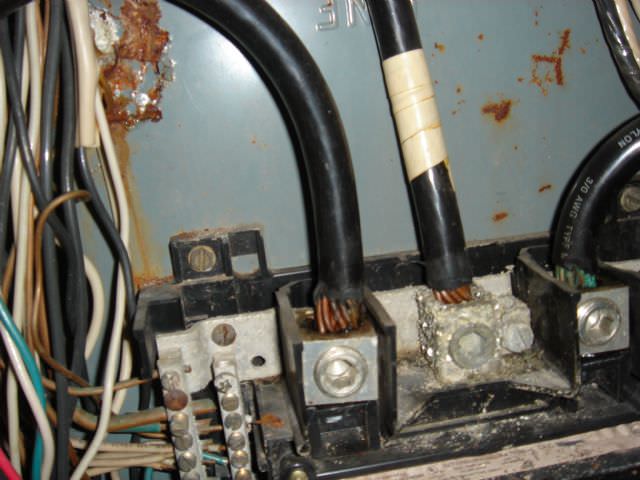

Stephen D. Gazo Posted February 13, 2010 Report Share Posted February 13, 2010 Why is only the one lug covered in corrosion. Unbalanced panel? To close to the left coast? Link to comment Share on other sites More sharing options...
Bain Posted February 13, 2010 Report Share Posted February 13, 2010 Why is only the one lug covered in corrosion. Unbalanced panel? To close to the left coast? Good question. I found something similar just last week. The panel was installed on the exterior wall of an 8" x 16" CMU building. I assumed condensation was forming on the neutral lug because the hots were better "insulated" by the plastic. Click to Enlarge 55.13 KB Click to Enlarge 64.98 KB Link to comment Share on other sites More sharing options...
Stephen D. Gazo Posted February 14, 2010 Report Share Posted February 14, 2010 your second pic shows bigtime copper oxidization. If that was the 00 starter wire on any car, I would almost bet it would drag and slow the starter, very notcible IR drop. That wire is a 120v ac, at the panel, how far back can you measure the wire for loss. Any of that Chinease drywall? Why is only the one lug covered in corrosion. Unbalanced panel? To close to the left coast? Good question. I found something similar just last week. The panel was installed on the exterior wall of an 8" x 16" CMU building. I assumed condensation was forming on the neutral lug because the hots were better "insulated" by the plastic. Click to Enlarge 55.13 KB Click to Enlarge 64.98 KB Link to comment Share on other sites More sharing options...
Ben H Posted February 14, 2010 Report Share Posted February 14, 2010 Why is only the one lug covered in corrosion. Unbalanced panel? To close to the left coast? Good question. I found something similar just last week. The panel was installed on the exterior wall of an 8" x 16" CMU building. I assumed condensation was forming on the neutral lug because the hots were better "insulated" by the plastic. Click to Enlarge 55.13 KB Click to Enlarge 64.98 KB Like Mongo, I think you have something going on. The left hot lug looks scortched/burned, the right has lots of green oxy on it.... strange indeed. Link to comment Share on other sites More sharing options...
Tom Corrigan Posted February 14, 2010 Report Share Posted February 14, 2010 This is typically caused by water traveling down the neutral conductor from the meter socket. The rubber compression ring on the meter inlet hub leaks. Rain water enters the meter can. The water then travels under the outer insulation of the lower cable and into the panel. The configuration of the conductors determines which terminals are damaged. Tom Corrigan Link to comment Share on other sites More sharing options...
