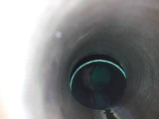

asihi Posted February 9, 2010 Report Share Posted February 9, 2010 This was not a call-back either, just helping out a past client on a house I didn't inspect. This had to do with their plumbing system. They have a typical 14 year old, Colonial style home in the suburbs of Chicago, PVC waste lines, copper supplies, overhead sewers, etc. All typical stuff for this area. The waste line in the basement exits the building through the front, the sump pump through the back. About 4 months ago, the homeowner started noticing a sewer gas smell from the sump pit. She poured some bleach in the pit thinking it was just stagnant water and forgot about it. Then she noticed in getting worse. She called out two plumbers, one trying to make the connection between the ejector pump and the sump pit (which are completely separated), the other, not smelling anything basically saying she's crazy. She even called out the village to scope a storm sewer that runs next to her house, but the smell continued. She calls me and after hearing what all of the other guys did, I told her to try a test, run the water in the building and go back to the sump pit. Sure enough, the water flowed in. The waste line sheared off outside of the foundation, leaked down the wall, into the drain tile and back to the sump pit. I haven't heard back from her yet about how everything turned out, but I'm sure it was a mess to fix. And from what I understand, she has some pretty expensive landscaping right where the plumber has to dig. Tony Link to comment Share on other sites More sharing options...
Jerry Simon Posted February 9, 2010 Report Share Posted February 9, 2010 The waste line sheared off outside of the foundation, leaked down the wall, into the drain tile and back to the sump pit. Tony That's so common. I found it in new construction just last week. Click to Enlarge 6.09 KB Link to comment Share on other sites More sharing options...

asihi Posted February 9, 2010 Report Share Posted February 9, 2010 The waste line sheared off outside of the foundation, leaked down the wall, into the drain tile and back to the sump pit. Tony That's so common. I found it in new construction just last week. Click to Enlarge 6.09 KB Jerry, What made you take off the clean out cover? Link to comment Share on other sites More sharing options...
Jerry Simon Posted February 9, 2010 Report Share Posted February 9, 2010 What made you take off the clean out cover? As Cust. Service Manager for a builder back in 1990 or so, got a call about a clogged sewer in a house still under its one-year warranty. This was the problem; soil back-fill pressure atop the sewer stub connection just outside the foundation, about 8-9' down, broke the connection. Ever since I started doing this, I've opened sewer main cleanouts where such are setup so you can see laterally into the sewer, and I've probably found a few hundred such broken connections. Remarkably common. Yes, beyond the standards, but a biggie to pay for to correct, so ya feel good for your client when you find one. The builder I was with when I first saw this then started to strap such connections to the foundation with a cradle-like thingy for support. Link to comment Share on other sites More sharing options...

Jerry Simon Posted February 9, 2010 Report Share Posted February 9, 2010 Do you carry a big wrench? You know it, big boy. Think how many things get screwed up by sloppy backfill.......this is just one of them. In new construction, where the pipe isn't all clogged with sewage, you'll often see ponding water ten feet or so back into the underground pipe, where the pipe *bellied* from the poor backfill/lack of an adequate amount of compacted stone under the pipe/soil pressure. I get a few "neighbor-jobs" out of those about the day after the builder digs up the front yard. Link to comment Share on other sites More sharing options...
