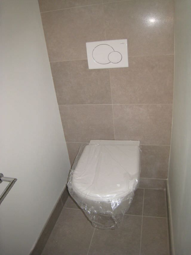

exploreparadise2 Posted February 3, 2010 Report Share Posted February 3, 2010 There's no tank visible at this toilet in a new construction. It's a wall-mounted commode with giant dual-flush buttons on the tiled wall. After a flush I could hear water filling behind the wall. It's not a pressurized unit. The other side of the back wall is a hallway with no access panel. This kind of installation was a first for me. Seems to me there should be an access somewhere. Click to Enlarge 38.66 KB Link to comment Share on other sites More sharing options...
Ben H Posted February 3, 2010 Report Share Posted February 3, 2010 Looks like a future nightmare to me. By the time someone noticed a leak, you would need a plumber, tile man, carpenter, ect...[:-crazy] Link to comment Share on other sites More sharing options...
Inspectorjoe Posted February 3, 2010 Report Share Posted February 3, 2010 Access to the moving parts is behind the flush actuator panel. I wouldn't want one of these things in my house. Click to Enlarge 25.76 KB Catalog Installation Link to comment Share on other sites More sharing options...
Tom Corrigan Posted February 4, 2010 Report Share Posted February 4, 2010 How about required access to the required water shutoff valve? Tom Corrigan Link to comment Share on other sites More sharing options...
Neal Lewis Posted February 4, 2010 Report Share Posted February 4, 2010 And how can you reach in and lift up the float when the toilet starts to overflow? Link to comment Share on other sites More sharing options...
Inspectorjoe Posted February 4, 2010 Report Share Posted February 4, 2010 You bang on the wall with all your might .......... and cross your fingers. Link to comment Share on other sites More sharing options...
Ben H Posted February 4, 2010 Report Share Posted February 4, 2010 And how can you reach in and lift up the float when the toilet starts to overflow? Oh, thats easy. Grab your BFH create a hole in the tile. Link to comment Share on other sites More sharing options...
