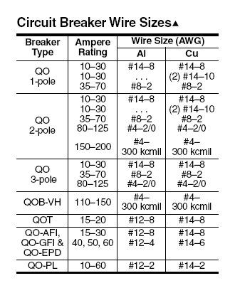

Tim Maxwell Posted February 2, 2010 Report Share Posted February 2, 2010 Hi guys/gals I know that many or most of the Square D breakers are designed for two wires and all but the AFCI breakers do not look like the attachment is made for two wires. Needless to say I have found one today on a new construction. I'm thinking NOT OK but wanted to check the board before reporting. Thanks Click to Enlarge 50.92 KB Link to comment Share on other sites More sharing options...
Robert Jones Posted February 2, 2010 Report Share Posted February 2, 2010 The bottom breaker does look double tapped. Is there room in that panel to add another breaker? Link to comment Share on other sites More sharing options...
Jim Port Posted February 2, 2010 Report Share Posted February 2, 2010 I don't remember if the AFCIs can accept 2 wires. A pigtail could be installed to alleviate this situation. Link to comment Share on other sites More sharing options...

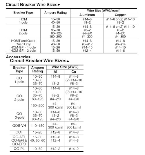

Richard Moore Posted February 2, 2010 Report Share Posted February 2, 2010 They only breakers listed as accepting 2 (copper) wires are the 10 through 30 amp, one or two pole, standard breakers. So no double-taps on AFCIs. Click to Enlarge 38.98 KB Download Attachment: SDwiresizes.jpg 63.55 KB Link to comment Share on other sites More sharing options...
Jack Davenport Posted February 2, 2010 Report Share Posted February 2, 2010 Square D AFCI breakers are not designed to accept multiple conductors. To correct this situation one would need to A) add another AFCI breaker or B) splice those wires together with a pigtail to the breaker Link to comment Share on other sites More sharing options...
