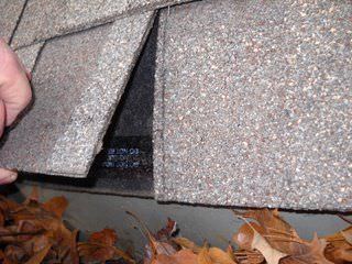

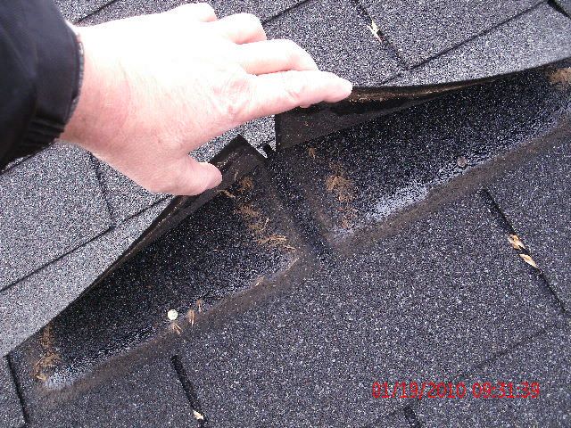

Phillip Posted January 29, 2010 Report Share Posted January 29, 2010 With out looking under the shingles you cannot make finds like theses Most roof in my area have shingles that not stuck to each other and can be blown off. Click to Enlarge 130.3 KB Missing nails and nailed too high. Click to Enlarge 128.96 KB And in this case missing the felt paper. Click to Enlarge 90.41 KB Link to comment Share on other sites More sharing options...
