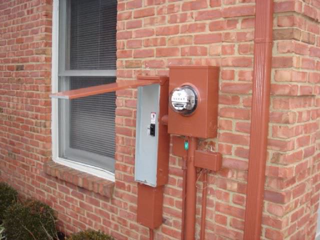

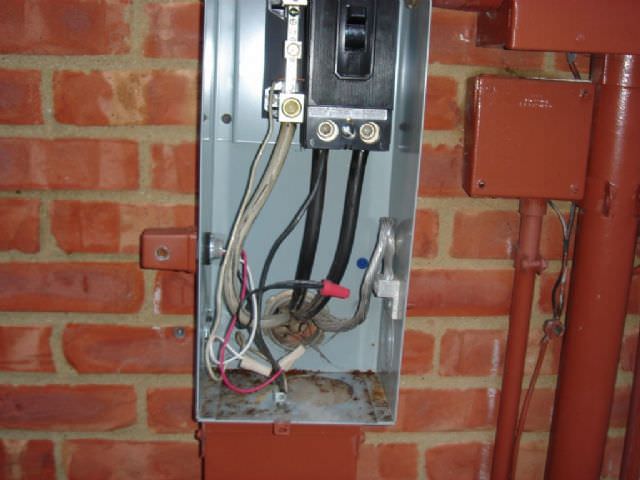

Bain Posted January 25, 2010 Report Share Posted January 25, 2010 . . . on the lower/left, exterior of the enclosure? My first though was a day/night sensor, but there wasn't anything obvious that it would have controlled. Click to Enlarge 46.22 KB Click to Enlarge 56.06 KB Link to comment Share on other sites More sharing options...
kurt Posted January 25, 2010 Report Share Posted January 25, 2010 Looks like a disconnected light sensitive photo-eye switch.....what's the right name for those? Link to comment Share on other sites More sharing options...
Brandon Whitmore Posted January 25, 2010 Report Share Posted January 25, 2010 Kurt, I think they're called photoelectric sensors, at least that's what I've always called them. Link to comment Share on other sites More sharing options...
Marc Posted January 25, 2010 Report Share Posted January 25, 2010 I call them photo-electric switches. Commonly used on municipal light poles in my area for dusk/dawn operation. Marc Link to comment Share on other sites More sharing options...
johnmcq Posted January 26, 2010 Report Share Posted January 26, 2010 Possibly a surge arrestor with an indicator light to show when it's been fried? Link to comment Share on other sites More sharing options...
hausdok Posted January 26, 2010 Report Share Posted January 26, 2010 It's not a surge arrestor - it's a light sensor-switch. They're used all the time around here on condos to light the public lighting automatically when the sun goes down. OT - OF!!! M. Link to comment Share on other sites More sharing options...
Bain Posted January 26, 2010 Author Report Share Posted January 26, 2010 Possibly a surge arrestor with an indicator light to show when it's been fried? That occurred to me, too. I just didn't know. We've had threads before that discuss how surge protectors are (wrongly, but typically )double-tapped into the SE lugs, so that's how I made the connection. I did, of course, hold my finger over the lens/sighthole to see if anything energized, but without any luck. Link to comment Share on other sites More sharing options...
Bain Posted January 26, 2010 Author Report Share Posted January 26, 2010 It's not a surge arrestor - it's a light sensor-switch. They're used all the time around here on condos to light the public lighting automatically when the sun goes down. OT - OF!!! M. You were typing while I was. None of the other townhouses had similar gizmos on the disconnect enclosures. I wonder if my unit was supplying power to a faux streetlight or something. Link to comment Share on other sites More sharing options...
Jim Katen Posted January 26, 2010 Report Share Posted January 26, 2010 It's not a surge arrestor - it's a light sensor-switch. They're used all the time around here on condos to light the public lighting automatically when the sun goes down. OT - OF!!! M. You were typing while I was. None of the other townhouses had similar gizmos on the disconnect enclosures. I wonder if my unit was supplying power to a faux streetlight or something. I sometimes see them controlling the indoor stairway night lights. You know, those little louvered lights over stair treads. When it gets dark out, the night lights come on. Pretty slick. - Jim Katen, Oregon Link to comment Share on other sites More sharing options...

John Kogel Posted January 26, 2010 Report Share Posted January 26, 2010 Would you call out that double-tap? That wouldn't be allowed in my area. Link to comment Share on other sites More sharing options...
Billy_Bob Posted January 26, 2010 Report Share Posted January 26, 2010 Yes that double tap is a no no! And the lower electrical box seems to have a conduit going into the ground. Probably to outside lighting. Place some black electric tape over the photocell and the outside lights should come on. With those style of photocell controls, you can get higher wattage switching which can handle quite a few lights. Like this 3000 watt control... http://www.residential-landscape-lighti ... 213PRE.htm Link to comment Share on other sites More sharing options...
Bain Posted January 27, 2010 Author Report Share Posted January 27, 2010 I did, indeed, bust the double-tap and also--ummm, very professionally, mind you--cover the lens with a finger and crane my neck like a damn idiot to see if any light fixtures illuminated. They didn't. That's why I asked you guys what the thing was. I was fairly certain it was a photo-electric sensor, but I didn't want to find out down the road that it was some sort of nuclear device or stun-system for teenagers who broke curfew. Link to comment Share on other sites More sharing options...

plummen Posted February 7, 2010 Report Share Posted February 7, 2010 why is it tapped in before the main? [:-bigeyes Link to comment Share on other sites More sharing options...
