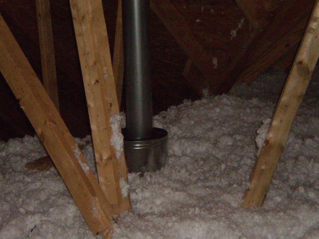

Firm Foundation Posted January 21, 2010 Report Posted January 21, 2010 This double sided B vent gas fireplace is burning a low blue flame, but when the glass front is opened the flame rises to a nice high orange flame, so I believe it's getting poor ventilation. The client has had the dealer out and they are saying that's the way it's supposed to burn (low blue), and the builder is at a loss as to how to improve so he added the larger vent pictured below in the attic. 1. Does this vent in the attic appear to be against fire code? 2. What would you recommend as to how to fix the fireplace? All opinions welcome, and thanks!
AHI in AR Posted January 22, 2010 Report Posted January 22, 2010 All the gas double sided fireplaces I am familiar with are designed for sealed use only. In other words, you can't remove one side of the glass front during use; they are fixed in place except when removed for cleaning. (Admittedly, I haven't seen all brands.) Clearly, the glass panel on the front side in the photo is a fixed panel since it's one piece. There is a built in air inlet. Unless that was not installed, you should have no problems getting air and using it as intended with both glass panels installed. As you stated, the unit works fine until a side is opened. There's no need to modify the manufacturer's system, and to do so would not be a good idea. I'd return the system to the configuration the mfr. requires. I can't tell what the attic shot reveals. That looks more like an insulation shield than a vent modification. More info would help.
Nolan Kienitz Posted January 22, 2010 Report Posted January 22, 2010 Kevin made referance to this: Where is the "make-up" or "supply air" vent. When you open the doors and the flame grows up it is taking that air to burn the flame from your living space. Should be a make-up air vent from the firebox to the home's exterior (NOT attic). Not sure what the deal is with the image in the attic around the B-Vent.

Scottpat Posted January 23, 2010 Report Posted January 23, 2010 As others have said this is how that unit is suppose to work, it sounds like an unvented log unit might have been used. If they want a higher flame yellow (not as efficient) they need a vented log system. In the photo of the vent pipe in the attic: If that is not a metal spacer keeping the insulation from around the flue pipe, then the insulation needs to be moved away from it so you have a 1" clearance or more around it. Did you by chance get the brand and model number of the log set?
