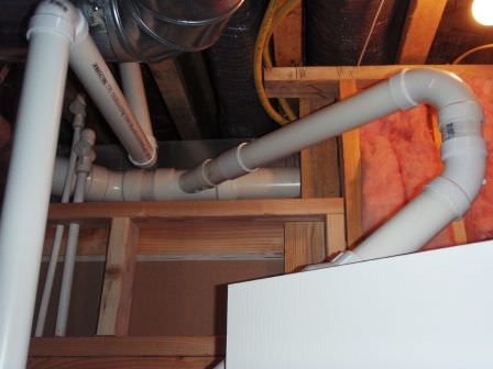

I seem to remember that a sewage ejector line has to enter on the top of the main line, is that correct? If so do you have a code reference?

For what it's worth, this is from the 2006 IPC
712.3.5 Ejector connection to the drainage system.
Pumps connected to the drainage system shall connect to the
building sewer or shall connect to a wye fitting in the building
drain a minimum of 10 feet (3048 mm) from the base of
any soil stack, waste stack or fixture drain. Where the discharge
line connects into horizontal drainage piping, the
connector shall be made through a wye fitting into the top of
the drainage piping.

3007.1 does not appear to address the install and I don't have a copy of the UPC. By chance can you post the UPC reference?
Bryan
710.4 The discharge line from such ejector, pump, or other mechanical device shall be provided with an accessible backwater or swing check valve and gate or ball valve. If the gravity drainage line to which
such discharge line connects is horizontal, the method of connection shall be from the top through a wye branch fitting. The gate or ball valve shall be located on the discharge side of the backwater or
check valve.
