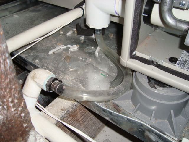

As Brandon, leaks are fairly common in these units. Here's a photo of one I did (a Rudd) in Dec that was previously repaired (the part were sitting on top of the unit).

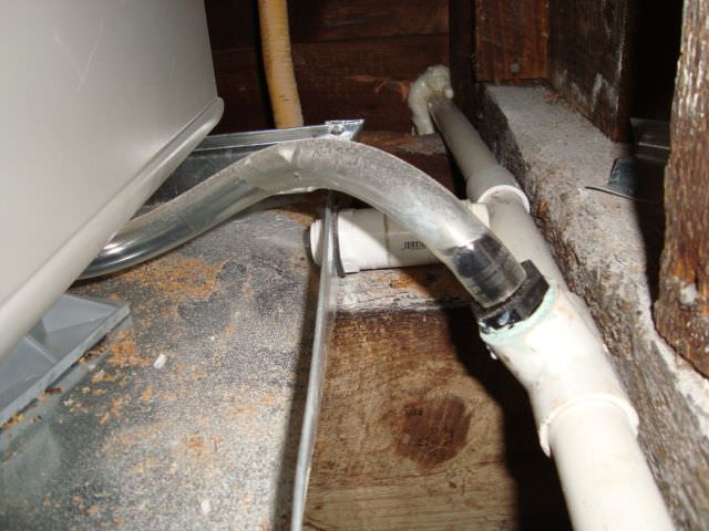

Here are a couple of shots of the horizontal unit. Cat IV

The last two both have the drain line running up hill to clear the pan to get to the drain line.
Click to Enlarge
35.04 KB
This shot shows the basement condensate line entering the waste stack, there is not trap below the entrance to the stack...
