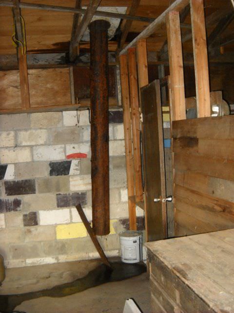

Mike Lamb Posted January 14, 2010 Author Report Posted January 14, 2010 I don't think patching or taping this is a good idea. The crack and rusting is very nearly a large hole in the pipe. A new roof cover is going to be put on when the weather softens so now is the time to do it IMO. As far as reward is concerned, I'm getting paid. Yes, the pipe is heavy. 25 pounds on the nosy. 4 x 5 x 30". Since we are in the plumbing section, pee seems a minor and natural thread drift. I'm looking at a lot of houses these days that have no running water and since I drink a lot of coffee, well, I've been going in hopefully discreet places. The police have not been called yet. I've gone in the back of the house, the side of the house, in bushes, and on roofs. But only flat roofs. Never on my shoes.

John Kogel Posted January 14, 2010 Report Posted January 14, 2010 I don't think patching or taping this is a good idea. The crack and rusting is very nearly a large hole in the pipe. A new roof cover is going to be put on when the weather softens so now is the time to do it IMO. As far as reward is concerned, I'm getting paid. Yes, the pipe is heavy. 25 pounds on the nosy. 4 x 5 x 30". Since we are in the plumbing section, pee seems a minor and natural thread drift. I'm looking at a lot of houses these days that have no running water and since I drink a lot of coffee, well, I've been going in hopefully discreet places. The police have not been called yet. I've gone in the back of the house, the side of the house, in bushes, and on roofs. But only flat roofs. Never on my shoes. The only thought I can add to this: Tie it up to a rafter first.The pipe, I mean. [] Before you cut it. [] If you take an angle grinder up there, bring a spark shield, cardboard at least. And a jug of water.
Marc Posted January 14, 2010 Report Posted January 14, 2010 I didn't think of it until now but a reason to not delay the repair of that vent stack is that it rains into that pipe with each rainfall. Tape might not serve very well. Marc
kurt Posted January 14, 2010 Report Posted January 14, 2010 OK, I'll be the sleaze...... I'd clean the crack, acetone it, and pack it with epoxy & cabosil fiber. Run a little glass tape over it when I was done packing, smooth it out, go have a refreshing beverage. Someday when the roof was replaced, I'd yank it and do it right.

Tom Raymond Posted January 15, 2010 Report Posted January 15, 2010 The only problem I see with Kurt's fix is that it will likely become permanent, the roofer will have no way of knowing that length of pipe needs replacing. That said, I like the epoxy putty and glass patch, with thorough prep it might even hold under far wetter service conditions. Nothing sleazy about a temporary fix that will has the potential to function indefinately, around here I would expect to see 3-5 inappropriate materials secured over that crack with everything from duck tape to zipties and hoseclamps. Taken a bit further, Kurt's approach might actually be a satisfactory permanent repair. If the entire length and circumference of the broken pipe section were prepped and wrapped in glass, and then while still wet wrapped in heavy cling wrap to evenly distribute the epoxy and ensure a thorough wet out, where exactly would it go? It only supports it's own weight, and with it's new composite skin would be at least as strong as anything you might replace it with, except maybe a new piece of iron. Polyester or vinylester resins would work just as well and be cheaper and easier to get, too. Ofcourse if there are more sections of iron above this one then it should be replaced. Tom
John Kogel Posted January 16, 2010 Report Posted January 16, 2010 a reason to not delay the repair of that vent stack is that it rains into that pipe with each rainfall. It needs a new stack, but that means a new thimble (roof jack) and that means fix the hole in the spring. [] This 8" pipe made a big puddle on the floor today, but it was a big rain , too. [] Click to Enlarge 55.18 KB

Ben H Posted January 25, 2010 Report Posted January 25, 2010 I tried a few years ago to cut out a cast vent pipe with a saw-zall. Kinda like trying to kill a grizzly bear with a bb gun.....Went and got one of those ratching chain cutters, had it in two in less than 5 min. Worked like a charm. However, for a winter fix, drop by HD and get a small jug of Fiberglass resin, and the woven matt. Cut the matt in 4" strips, duct tape the top of it to the pipe and let it hand down. Brush a little resin on the pipe ( to make it sticky) lay a 3-4 layers of the matt. Depending on temp, it might take a day or two to set. But when it does, it's never comming off.
Mike Lamb Posted January 25, 2010 Author Report Posted January 25, 2010 Click to Enlarge 34.9 KB Click to Enlarge 56.05 KB Mission accomplished. Good day today. 40F. Very light, misty Irish rain. Damn near balmy. Click to Enlarge 34.81 KB I removed the old packing at the joint and pulled the mofo out through the roof. I thank everyone for your comments.
