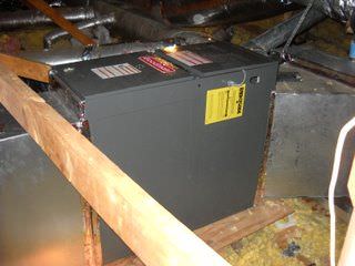

charlieb Posted January 13, 2010 Report Share Posted January 13, 2010 New HVAC system installed this summer. Click to Enlarge 11.41 KB Click to Enlarge 17.62 KB Click to Enlarge 16.44 KB Link to comment Share on other sites More sharing options...
Richard Moore Posted January 13, 2010 Report Share Posted January 13, 2010 I know that the furnace is probably "multipoise" but I'm fairly certain that on its back is not one of the listed positions. One of the 11 defects I assume. Link to comment Share on other sites More sharing options...
Marc Posted January 13, 2010 Report Share Posted January 13, 2010 I agree, so what's it doing on it's back? I mean, we don't have people that are made THAT stupid, do we? Marc Link to comment Share on other sites More sharing options...
charlieb Posted January 13, 2010 Author Report Share Posted January 13, 2010 Correct. I made a quick call to confirm that is one of the defects. Marc, you don't. Only we in MS have someone stupid enough to to this. I'm taking a break from writing the report. I'm three hours into it. Link to comment Share on other sites More sharing options...
