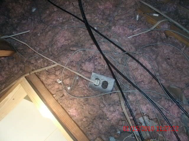

Phillip Posted January 17, 2010 Report Share Posted January 17, 2010 I wonder if I should report this as a grow-op?[:-monkeyd Added plug in attic Click to Enlarge 60.95 KB Ropes tied to joist and other items. Click to Enlarge 57.19 KB Another photo of the plug, Click to Enlarge 52.15 KB Link to comment Share on other sites More sharing options...
John Kogel Posted January 17, 2010 Report Share Posted January 17, 2010 I wonder if I should report this as a grow-op?[:-monkeyd Added plug in attic Click to Enlarge 60.95 KB Ropes tied to joist and other items. Click to Enlarge 57.19 KB Another photo of the plug, Click to Enlarge 52.15 KB That brings up a good point. If you label the house a grow-op around here, you just de-valued the place by about 100G.I describe what's there - "I saw some fluorescent lights hanging in the attic.""The previous tenants left some herbs hanging from the rafters". Stuff like that. Then I will be on the lookout for damage, too, but still haven't used the G word. Link to comment Share on other sites More sharing options...

Phillip Posted January 18, 2010 Report Share Posted January 18, 2010 I have found grow-ops before. I think I posted some photos from the one I found in the back of a crawlspace. To me there is not enough signs for me to call this a grow-op. I just reported about the outlet, ropes being there for some unknown reason and the gable end vent needing repair. Link to comment Share on other sites More sharing options...
gtblum Posted January 18, 2010 Report Share Posted January 18, 2010 I have found grow-ops before. I think I posted some photos from the one I found in the back of a crawlspace. To me there is not enough signs for me to call this a grow-op. I just reported about the outlet, ropes being there for some unknown reason and the gable end vent needing repair. I think that's a wise decision. Looks to me like the dryer broke, and they were hanging clothes in the hot attic to dry them. The extra wiring was for the oscillating fan used to move the air around the clothes. Not as exciting as guessing there may have been a grow opp but, a lot less dangerous. Link to comment Share on other sites More sharing options...
