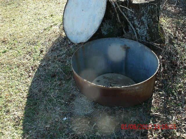

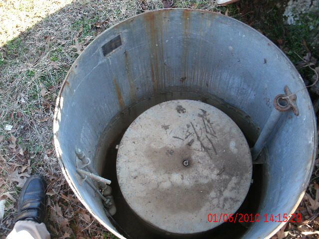

Phillip Posted January 7, 2010 Report Share Posted January 7, 2010 Buyer told me what it is. First time I have seen one. Click to Enlarge 78.61 KB Click to Enlarge 118.19 KB Click to Enlarge 55.44 KB Link to comment Share on other sites More sharing options...
Richard Saunders Posted January 7, 2010 Report Share Posted January 7, 2010 Apparently this household needed acetylene for something, maybe a post / yard light? Link to comment Share on other sites More sharing options...
Bill Kibbel Posted January 7, 2010 Report Share Posted January 7, 2010 Apparently this household needed acetylene for something, maybe a post / yard light? Where city gas wasn't available, acetylene could be generated for lighting throughout the house.Details here: http://www.oldhouseweb.com/blog/gas-lig ... -the-city/ Link to comment Share on other sites More sharing options...
Phillip Posted January 7, 2010 Author Report Share Posted January 7, 2010 Y'all are right. This is out in the country. All of the piping from the pit was removed from the home. Daddy had some of the miner lights that we used to go coon hunting when I was a boy Link to comment Share on other sites More sharing options...
