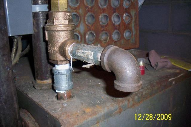

mgbinspect Posted December 29, 2009 Report Share Posted December 29, 2009 It was impossible, due to arrangement, to read the label on this component. This is an old oil-fired boiler. Is this a T & P valve? I'm not certain. What has me wondering is that near the boiler IS a removed T & P valve which I was familiar with. I've not seen one quite like this before (the one installed, if in fact that is what it is), so if you're familiar with this particular component, I'd greatly appreciate confirmation, as I'm writing the report this morning. I'm already aware of the lack of an extension tube. Click to Enlarge 49.44 KB Thanks in advance! Link to comment Share on other sites More sharing options...
Terence McCann Posted December 29, 2009 Report Share Posted December 29, 2009 There is a nut on top of it? Got a picture showing the whole thing? Never mind, saw a shot in your other post. Doesn't look like any safety valve I've ever seen. All the safety valves I've seen on boilers have a lift handle to manually pop them. Perhaps one of the other gents knows. Got a pic without the date stamped over it (referring to the pic in your other post)? Link to comment Share on other sites More sharing options...
mgbinspect Posted December 29, 2009 Author Report Share Posted December 29, 2009 Yeah, it just doesn't look right and apparently it isn't ringing any bells with anyone else. I too am used to seeing valve more akin to what is seen on a water heater. I'm writing it up anyway, and it's time to send the report off, but it would have been nice to be a bit more definitive. Link to comment Share on other sites More sharing options...
Bill Kibbel Posted December 30, 2009 Report Share Posted December 30, 2009 I'm pretty sure it (was) a pressure-only relief valve - like the type used in fairly high-pressure water systems that use positive displacement pumps. They're installed on the pressure side of pumps to help prevent damage to a pump if there is blockage in the system. It is not manufactured for boilers or water heaters. Where the brass nut is attached to the bronze body, there should be a T-handle valve for adjusting the pressure. Link to comment Share on other sites More sharing options...
mgbinspect Posted December 30, 2009 Author Report Share Posted December 30, 2009 Thanks Bill, I didn't think it looked right. I called for an extension tube and confirmation by a licensed HVAC contractor that the proper components were in place. That was the least of this homes problems since the block foundation wall was so buckled in that the floors were pushed up about two inches. It was bad and in need of immediate arrest, before it all together failed. Link to comment Share on other sites More sharing options...
