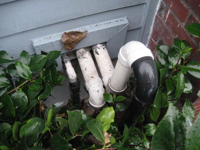

Richard Moore Posted December 22, 2009 Report Share Posted December 22, 2009 Just because you don't want condensation near the house, this is NOT a good idea. From another inspector...Cat IV furnace, the exhaust goes from this photo, to a buried 4" ABS pipe that comes out in part of the yard away from the house. Evidently, he was somewhat surprised, at first, to see steam coming from some shrubbery. Click to Enlarge 70.67 KB Link to comment Share on other sites More sharing options...
