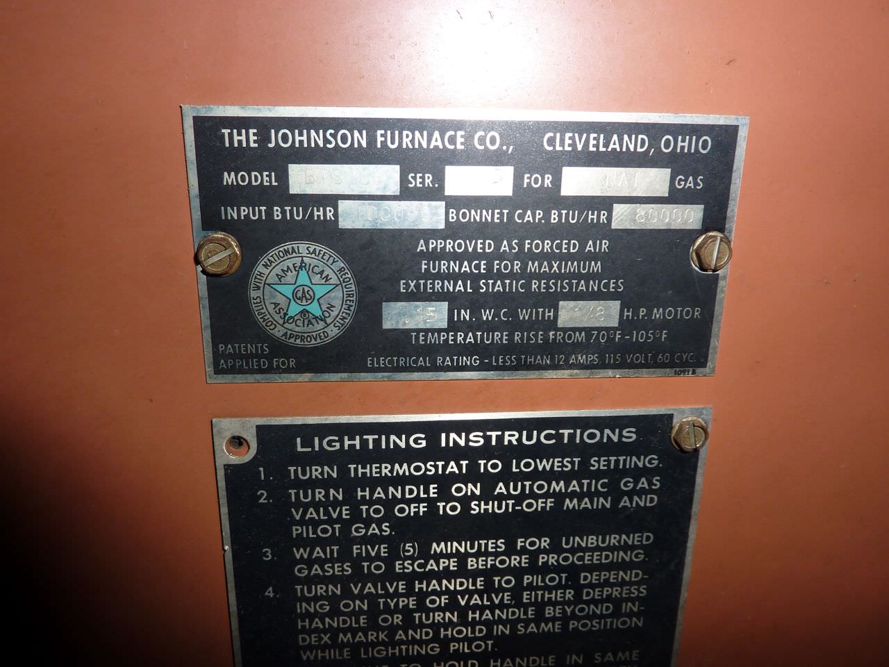

RickSab Posted December 19, 2009 Report Share Posted December 19, 2009 Todays inspection had a Johnson Furnace in it. The serial number on the unit was #3 stamped into the plate. Mad# looks like BTS100. 100,000/80,000 btu. No blower door switch. A single huge burner (like a hot water heater. The unit ran flawlessly and was very quiet. There is a strange vent configuration. I need help with two things: Age and what do you think of this flue set up? The flue runs through the return air into a box on the outside of the furnace and then up the flue to the chimney. But the box on the side has no bottom. Download Attachment: P1000256.jpg 172.48 KB Download Attachment: P1000259.jpg 172.45 KB Link to comment Share on other sites More sharing options...

mgbinspect Posted December 19, 2009 Report Share Posted December 19, 2009 I agree with Brandon. It was configured this way by the manufacturer, probably to recover some of the heat loss in exhaust to pre-heat return air - high tech for it's day. Seeing the burner setup would be a great help in guessing its age, but simply based upon the cabinet color and the appearance of the information plate (dating myself) I'd guess that furnace is pushing 45 to 50 years old. Link to comment Share on other sites More sharing options...
Rob Amaral Posted December 19, 2009 Report Share Posted December 19, 2009 I'm guessing that furnace could be somewhere between 1959-1964? or so? I see brand-new oil-fired furnaces that have the exhaust-vent running through the return just like that today. Brand-new. It has always struck me as not a great idea, because you're robbing the exhaust of heat which could possibly adversely affect the quality of the draft. Then what happens if the vent gets rusted-through or compromised with a bad weld? (I always check for that with a mirror, but I've yet to see a problem.. yet..). Some of these lowboys were used because of the location of the fuel source and the chimney (I guess..) and the duct work in general. I've never seen a gas-fired unit with the 'draft hood' outside nearby the blower-end like that (yet). I'd say that the blower door should be kept tightly-closed (maybe even taped) to prevent negative pressure from affecting that draft. How was the 'draft' when the unit was running (with the blower-door closed?). I'd have put my mirror around the base of that draft hood during burner+blower operation.. If you had given us the age of the house and a stand-back shot...it may have helped... Link to comment Share on other sites More sharing options...

Bill Kibbel Posted December 19, 2009 Report Share Posted December 19, 2009 The furnace pictured is more likely from the early to mid '60s. The external "box" is no different than draft hoods installed inside the furnace cabinet. It's not a flue connector passing through the return compartment. It's a heavy gauge, welded-seam steel tube. I've never found one leaking byproducts of combustion or found anything but minor surface rust from humidifiers. That's a very common style of furnace here. They're still manufactured in that style for oil-fired systems. Link to comment Share on other sites More sharing options...
RickSab Posted December 19, 2009 Author Report Share Posted December 19, 2009 You guys are a wealth of knowledge. This unit is in a town home. It was built about 1950. A newer Lennox AC has been added and a Kenmore humidifier. The unit is Mod# BTS100 the serial number is 3.Except for the bottom of the cabinet there is no rust. It runs great and may for many more years to come. I could not find much on the internet so I turned to the best knowledge base I know of. All You guys. Thanks Again Link to comment Share on other sites More sharing options...
