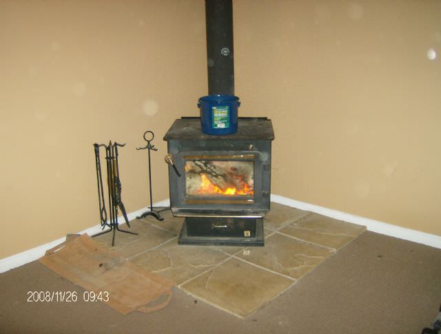

Stephen D. Gazo Posted December 16, 2009 Report Share Posted December 16, 2009 Gidday all, I could use some of the vast knowledge base that is TIJ. I have an approx 1800btu wood stove hooked up and certified in my basement. I did this two years ago. Works great. Gets up to 400f quickly and not much problems with back draft (friggin furnace), I think I have my aux heating solved, to this point. What I want to do is stop using my drywall as a heat sink. The stove sits in the corner of the basement atop a 2" thick pad of slate thats cemented down to the basement pad and grouted. It is away from both walls as per MII, plus 2" (safety). All piping I used is double wall and not an issue. My issue is the drywall gets hotter than I feel comfortable with. The paint is feeling it as well. I am thinking if I could add a nice looking reflecting heat shield, out of masonry (?), air gap between it and the drywall. I say masonry to steer away from sheet metal. Could I make a wall starting in the corner and maybe step down as it moves away from said corner. Something that fits into the 'fit, form and function'. Obviously it needs to stand up to the heat, but I would like it to look nice as well. Any ideas. thanks steve Link to comment Share on other sites More sharing options...

Stephen D. Gazo Posted December 16, 2009 Author Report Share Posted December 16, 2009 ref pics...this being xmas around here my wife cleaned. I am almost emabarrassed, where is that friggin usb cable...wait out... Link to comment Share on other sites More sharing options...

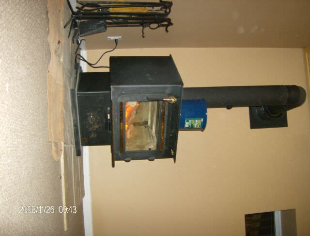

Stephen D. Gazo Posted December 16, 2009 Author Report Share Posted December 16, 2009 here we go. the area is 10x 12. Three walls and an eye-level basement window top right. very high finished ceiling. its heating the wall and I want to heat the house. if your note using a lap top this is sideways, sorry Click to Enlarge 37.14 KB Click to Enlarge 30.47 KB Link to comment Share on other sites More sharing options...
Brandon Whitmore Posted December 16, 2009 Report Share Posted December 16, 2009 If I was worried about the wall getting too hot (to it's flash point), then I'd be doing a clearance reduction installation with either brick or metal. The brick is going to just absorb a great amount of heat and not reflect it into the room that well, at least in my opinion. Once the fire goes out, the mass of warm/ hot brick will still heat that room for at least a while. If I just wanted to circulate heat better, and had a set up like yours, I would buy one of these:http://www.northlineexpress.com/itemdesc.asp?ic=5NC-MH-6R , http://www.northlineexpress.com/itemdes ... c=5VZ-HR-6 or something similar. My buddy has one in his shop, and I'm impressed. Link to comment Share on other sites More sharing options...
Stephen D. Gazo Posted December 16, 2009 Author Report Share Posted December 16, 2009 If I just wanted to circulate heat better, and had a set up like yours, I would buy one of these: http://www.northlineexpress.com/itemdes ... c=5VZ-HR-6 or something similar. Brandon, thanx. No worries, about getting to flash point..but I want efficiency everywhere. When the stove gets going I have large 36' stand up fan, it moves nice cool air into and around that box. Its that the walls get warm and I would rather see that heat heat somewhere else. As for your buddy, his plan may work, but inside my basement those pipe are double walled and give of almost zero heat. I installed telescoping pipes, I knew I was going to put a reflector of some sort. I keep going back to some stone work. Gotta read the stuff you sent me. thanx mongo Link to comment Share on other sites More sharing options...
Brandon Whitmore Posted December 16, 2009 Report Share Posted December 16, 2009 As for your buddy, his plan may work, but inside my basement those pipe are double walled and give of almost zero heat. Yeah, you'd have to use some single walled material at the vertical section above the stove. If clearance requirements are still met, the fan still may be a good idea as it is re- claiming a lot of heat that is otherwise sent outside. The reviews on both units I linked were all good. I'm sure someone on here who is much smarter will come up with a better solution before long. Link to comment Share on other sites More sharing options...

mgbinspect Posted December 17, 2009 Report Share Posted December 17, 2009 One really nice feature of using brick or some other dense material is thermal mass - (the ole' Spock phasering some rocks to keep Jim from freezing on some desolate planet when a chick lured Jim and the enterprise there...) I always wondered why Spock didn't eliminate Jim for the needs of the many.. [:-alien] But, a nice thick masonry wall with a cavity behind it will radiate even heat for quite a while after the stove settles down. You can even put a few openings similar to large weep holes at the bottom to promote convection through the cavity behind the reflecting/radiating wall. I used to make this installation all the time out in the hills of Loudoun County VA. Works well! Link to comment Share on other sites More sharing options...

Marc Posted December 17, 2009 Report Share Posted December 17, 2009 I would install two brick walls at a right angle to each and joined together behind the stove. Leave several inches between the brick and the walls and place the first course of brick on angle iron that is securely supported an inch or so above the floor. It doesn't have to be glowing red to radiate heat. Even when just warm, it will radiate heat clear across the room to the opposite wall unless there is an obstruction in the way. Remember the three ways that heat energy moves: convection, conduction and radiation. Marc Link to comment Share on other sites More sharing options...
Stephen D. Gazo Posted December 17, 2009 Author Report Share Posted December 17, 2009 Marc, exactly, I even have a sketch like that with a few pidgeon holes drawn, anchors etc, but are all bricks equal? red brick, fire brick, aged. so many types. is there ones to avoid...this is the last house I may own (lottery may change that) I built it three years ago. If I put something behind that stove I am going to do it once. My aggravation is aggragate. as it were Link to comment Share on other sites More sharing options...
