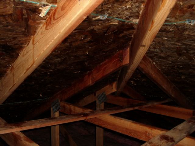

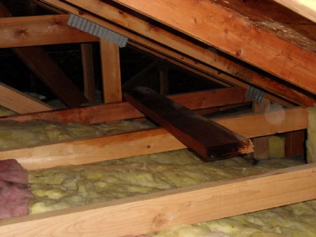

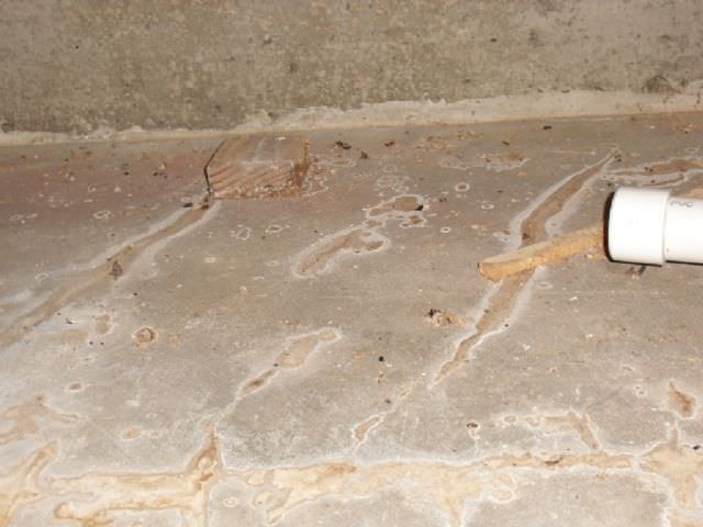

Ponyboy Posted December 14, 2009 Report Share Posted December 14, 2009 Afternoon inspection today has been vacant since April, heat off until the inspection today, built in 1999. Slab-on-grade daylight basement. No vapor barrier on the attic insulation. Get into the attic and it is soaking wet. All of the OSB is moldy, wet and slightly swelled. Water is dripping everywhere and the insulation and trusses are wet with water dripping off of the sheathing. The eave vents were blocked with the cardboard insulation dams. In the garage the slab is spider cracking and water stains were present at all of the cracks. A few larger cracks clearly look like water coming in through the cracks. The basement laundry room did smell musty and some mold was observed on the lower sheetrock which is against the foundation wall. The vinyl floor also had purple staining consistent with moisture damage. Could slab moisture be making it through the house and condensing in the attic? Click to Enlarge 62.37 KB Click to Enlarge 49.76 KB Click to Enlarge 48.5 KB Click to Enlarge 43.97 KB Click to Enlarge 47.77 KB Link to comment Share on other sites More sharing options...
mgbinspect Posted December 14, 2009 Report Share Posted December 14, 2009 My guess is that the origin of the moisture is, as you suspect, from inside the home, but the heavy condensation smacks of a severely under-ventilated attic. These banks really make a huge mistake when they elect to stop conditioning the home. Any potential humidity problem becomes all too real once the HVAC is unplugged. Link to comment Share on other sites More sharing options...

Ponyboy Posted December 14, 2009 Author Report Share Posted December 14, 2009 This house was located North of Granite Falls. Icy snowy roads on the way out and worse on the way home. The house had been owned by the same person since built. I don't think anybody been in the attic over the last ten years. This condition really looks like a long term problem. I will be recommending unblocking the eave vents and adding a fan to improve air movement in the attic. I am also going to recommend further investigation by a mold expert. The roof sheathing was swelling from moisture, but I was not going to recommend removing it? The moisture from the slab is the really intriguing part. The picture doesn't show the problem well. But every hairline crack in the slab looks like muddy water has seeped up and dried. A few cracks had clear evidence of active water seepage. I am writing this report today so I was looking for other opinions. Link to comment Share on other sites More sharing options...
Chad Fabry Posted December 14, 2009 Report Share Posted December 14, 2009 The roof sheathing was swelling from moisture, but I was not going to recommend removing it? Geez, I would. If you're dead set against saying "the sheathing should be replaced." How about, "The sheathing is swollen and covered in mold. I'm betting that it'll need to be replaced to ensure structural stability and to reduce the area affected by mold. Re-decking then re-roofing then re-insulating the attic spaces along with any necessary mold remediation can easily add up to a very significant amount of money. Expect to pay 12-20 dollars a square foot. The affected areas are approximately xxx square feet. There may also be, and probably is, more damage that's yet to be discovered that could push those costs even higher." Link to comment Share on other sites More sharing options...

Ponyboy Posted December 14, 2009 Author Report Share Posted December 14, 2009 No furnace or humidifier in this house. The house is heated by electric wall heaters. Chad, I am not against recommending a tear-off, just wanted to check with some folks before I made the call. I have not observed an attic this bad before. I will recommended roof and sheathing replacement, more ventilation and further investigation of the walls for moisture damage. Great forum for talking about these issues. Link to comment Share on other sites More sharing options...
randynavarro Posted December 14, 2009 Report Share Posted December 14, 2009 I wouldn't hestitate to write that the roof sheathing needs replacing. Also, IMO, attic fans may not help much. They've got to stop air leakage from the house in to the attic. And then: I wouldn't recommend a "mold expert." It'd probably create more confusion than it would solve. After all, once the sheathing is replaced, the mold will be gone - notice it isn't infesting the truss wood. That's curious in and of itself. In fact, what's growing up there may not even be mold. Camhoin Connell (sp?) would have some interesting things to say about this one. . . Link to comment Share on other sites More sharing options...
