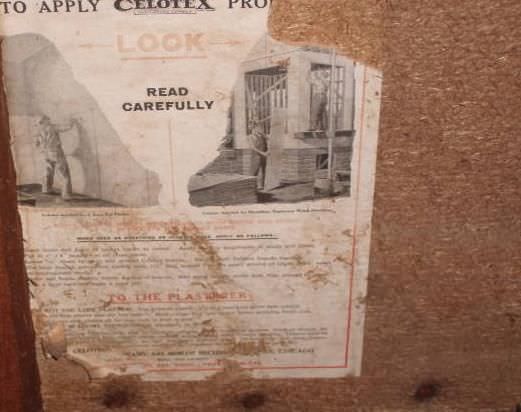

Bill Kibbel Posted December 14, 2009 Report Share Posted December 14, 2009 Using bagasse for an alternative building product isn't new. The original Celotex was made from it as early as 1920. Click to Enlarge 37.71 KB Link to comment Share on other sites More sharing options...
mgbinspect Posted December 14, 2009 Report Share Posted December 14, 2009 Well, at three inches thick is it used as something more than simply a wall sheathing? Link to comment Share on other sites More sharing options...
Michael Brown Posted December 14, 2009 Author Report Share Posted December 14, 2009 Using bagasse for an alternative building product isn't new. The original Celotex was made from it as early as 1920. Click to Enlarge 37.71 KB The big difference here was the separation process before making the product. They usually just grind it all up and make the product out of that, but the wax is never wanted and the inside of the cane isn't wanted in this application. Yes it was something more than simply a wall sheathing it was also for structure... made for developing countries where there is very little wood. Michael Link to comment Share on other sites More sharing options...
Les Posted December 14, 2009 Report Share Posted December 14, 2009 Using bagasse for an alternative building product isn't new. The original Celotex was made from it as early as 1920. Click to Enlarge 37.71 KB Bill I can't read the photo, but am surprised it was from sugar cane. Most of that product was made from wood sawmill waste. I thought. Link to comment Share on other sites More sharing options...
Bill Kibbel Posted December 15, 2009 Report Share Posted December 15, 2009 Using bagasse for an alternative building product isn't new. The original Celotex was made from it as early as 1920. Click to Enlarge 37.71 KB Bill I can't read the photo, but am surprised it was from sugar cane. Most of that product was made from wood sawmill waste. I thought. No sir. The original Celotex was made from the waste of sugar cane processing since the early 1920s. In the mid-late 1930s, the Celotex company diversified into other products including flooring, sheathing, wallboard, some of which contained stuff like reclaimed sawdust and newsprint. I don't know how long they continued manufacturing the original bagasse-based product, but I find it regularly in homes built up until WWII. It has a much different texture, density and sheen than the wood-cellulose boards. I can also usually find a label too. In the late 70s, Celotex Inc. was revived and manufactured the foam insulating board. Later it became Knight-Celotex and primarily made a sound-insulating product. It went bankrupt this year and the Celotex name sold to Blue Ridge Fiberboards. Link to comment Share on other sites More sharing options...
