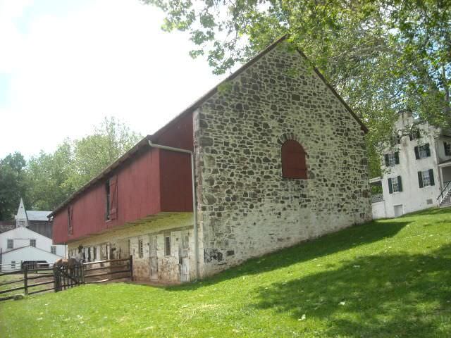

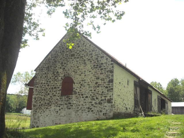

Bill Kibbel Posted December 1, 2009 Report Posted December 1, 2009 A bank barn is either built into a hillside or a ramp is created to easily enter the upper level with wagon loads. The upper level is hay and grain storage and the lower level is for livestock. I've inspected over 4500 barns and maybe about 15% weren't bank barns. Click to Enlarge 64.22 KB Click to Enlarge 72.86 KB
Les Posted December 1, 2009 Report Posted December 1, 2009 Bill, Would you agree that of the 85% that are bank barns maybe half or more involved changing a grade to accomodate access? In many areas the bank barn may be the most practical way/style to build, yet in the flat lands moving a little dirt made access easy. Michigan barns had most of the grain storage on the lower levels, except corn and that was always stored in a crib that was attached or free-standing.

Bill Kibbel Posted December 2, 2009 Report Posted December 2, 2009 Bill, Would you agree that of the 85% that are bank barns maybe half or more involved changing a grade to accomodate access? In many areas the bank barn may be the most practical way/style to build, yet in the flat lands moving a little dirt made access easy. Michigan barns had most of the grain storage on the lower levels, except corn and that was always stored in a crib that was attached or free-standing. Hi Les, I see just about 35% of the bank barns here that have earthen ramps created for upper level access. There's plenty of sloping hills on farms here. The "downhill" side always faces south, with only one odd exception. Occasionally there's a ramp and a "bridge". Here the upper level, center bay floors were used for threshing. The bays flanking the fleshing bays were "hay mows" That were filled to the rafters in the fall. The cantilevered forebay was used for grain storage. There's usually a drop chute, from the roof rafters all the way down to the lower level, for supplying the stalls with bedding and feed for the livestock. Mongo, There were many homes in colonial PA built into hillsides, like my first house, circa 1690. They're simply referred to as "bank houses".
