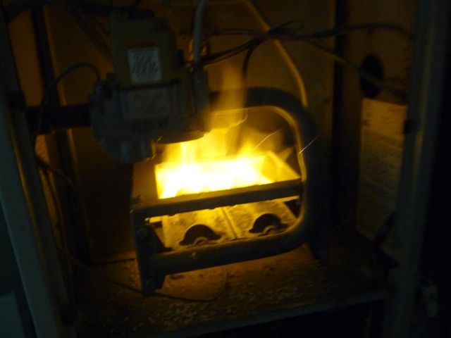

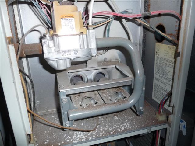

gtblum Posted November 30, 2009 Report Posted November 30, 2009 Click to Enlarge 59.73 KB Click to Enlarge 26.83 KB
Neal Lewis Posted November 30, 2009 Report Posted November 30, 2009 Is that delayed ignition or rollout? Furnace is from 1995?
gtblum Posted November 30, 2009 Author Report Posted November 30, 2009 Is that delayed ignition or rollout? Furnace is from 1995? Hi Neal, 95 is correct. I can't give you an honest answer if a delayed ignition is the cause of the rollout but, if the guy gets an HVAC contractor like I suggested, he'll know. For my own education, what would I see or hear that might indicate the possible cause?
Terence McCann Posted December 1, 2009 Report Posted December 1, 2009 For my own education, what would I see or hear that might indicate the possible cause? When did that roll out occur, upon 1st ignition or when the main blower started?
gtblum Posted December 1, 2009 Author Report Posted December 1, 2009 For my own education, what would I see or hear that might indicate the possible cause? When did that roll out occur, upon 1st ignition or when the main blower started? Hi Terry, Every time I pressed the the safety switch. That's how I timed the camera. 1st ignition. If I'm understanding what you mean.
Terence McCann Posted December 1, 2009 Report Posted December 1, 2009 Hi Terry, Every time I pressed the the safety switch. That's how I timed the camera. 1st ignition. If I'm understanding what you mean. What safety switch were you pressing? I take it then you had blow back when the gas valve first opened. Most likely a gas pressure problem. Could be too high coming into the house too. When the gas valve opens you get a surge until the pressure regulator starts to clamp down. When my Goodman furnace took a dump that would happen when the main blower started. Only reason I found it was the burners were short cycling during the heating cycle so I went to see what was wrong. Cracked heat-x.
