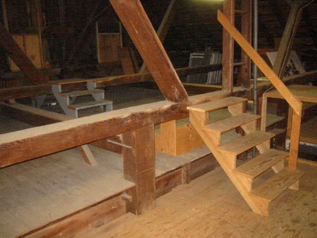

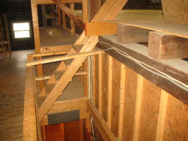

Inspectorjoe Posted November 29, 2009 Report Share Posted November 29, 2009 You know Mongo, for me, one of the fringe benefits of this gig is seeing the inner workings of cool and unusual buildings and having a never ending stream of bizarre and wacky stuff to discover. On that same inspection that I ran across the blacktopped second floor was a Pennsylvania bank barn that was divided up into multiple levels of stockrooms. It was the most concentrated collection of trip and fall hazards I've ever encountered - not to mention being a deathtrap if a fire would ever break out. Click to Enlarge 51.98 KB Click to Enlarge 53.52 KB Click to Enlarge 51.98 KB I have hundreds and hundreds of pictures of goofy things people have done to buildings. Somebody told me that I should put them on a web site. So I registered stupidhousetricks.com and paid for hosting for a year. That's as far is it got. I just got a notice from Godaddy that my year of paid hosting is ready to expire. To GD's credit, they did call me last January and said they noticed that I hadn't put a site up yet and wondered if I needed any help. Maybe I'll make doing that site a New Year's resolution and finally get it off the ground. Til then, my picture collection will only get bigger! Link to comment Share on other sites More sharing options...
