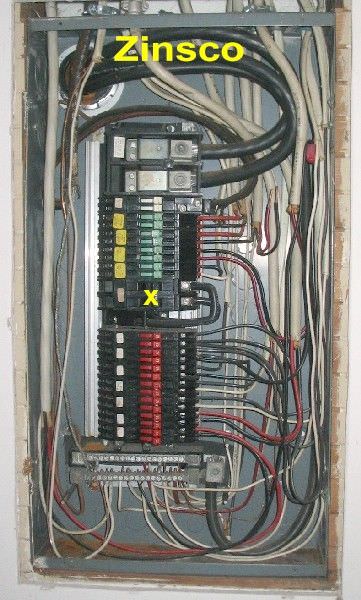

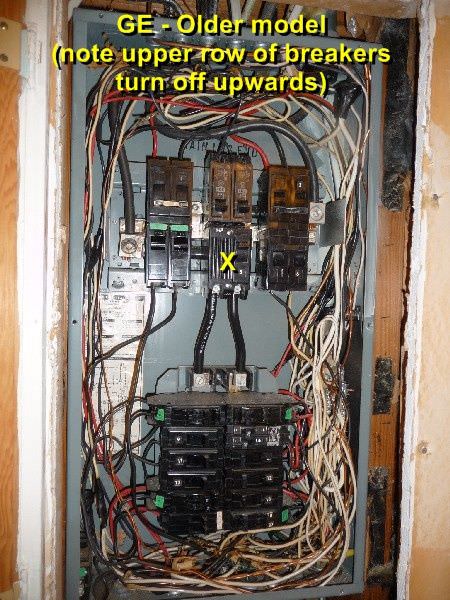

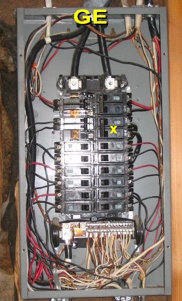

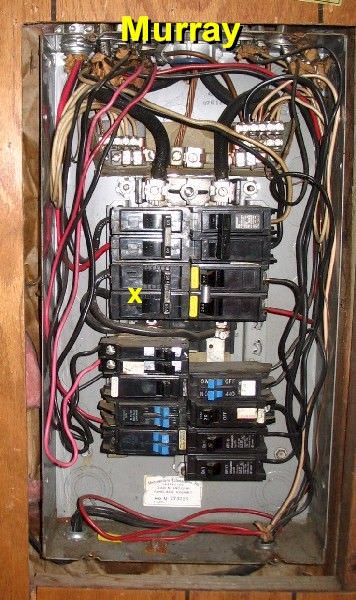

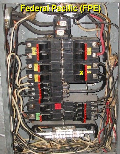

Richard Moore Posted October 28, 2009 Report Share Posted October 28, 2009 I may have posted this before a long time ago, but I thought it might be of some use after the other split-bus thread. In each case I have marked the breaker that feeds the lower half with an "X". Click to Enlarge 68.28 KB Click to Enlarge 89.42 KB Click to Enlarge 70.72 KB Click to Enlarge 92.3 KB Click to Enlarge 74.41 KB Click to Enlarge 55.72 KB Click to Enlarge 67.53 KB And there are many variations of those. Link to comment Share on other sites More sharing options...
