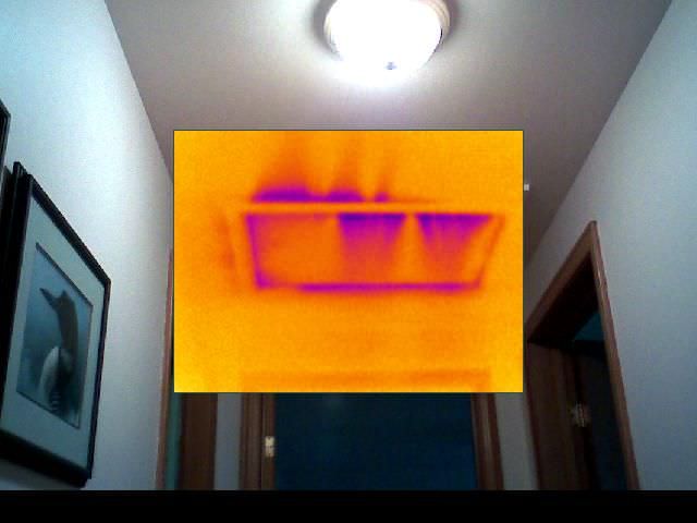

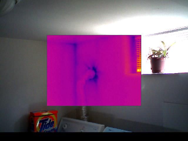

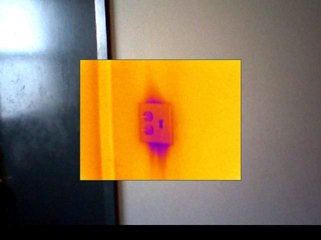

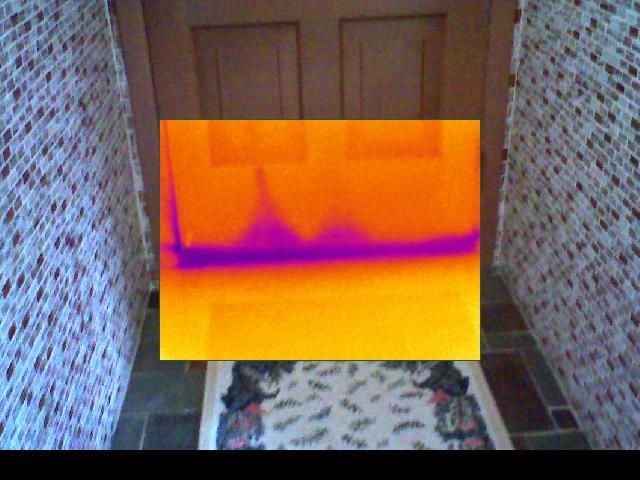

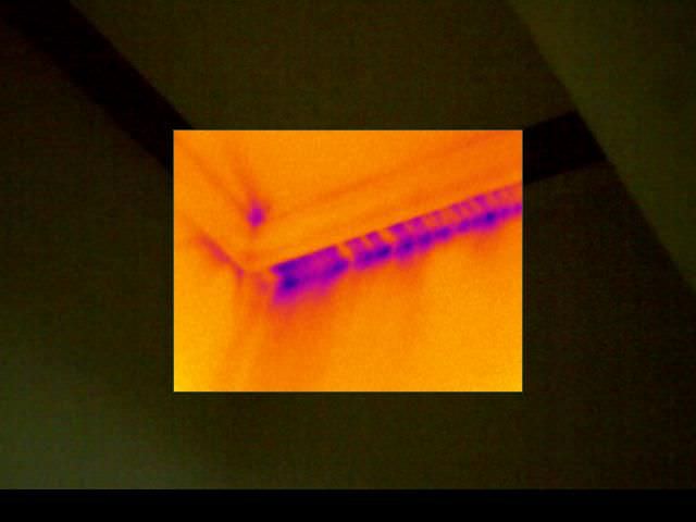

Brad Manor Posted October 20, 2009 Report Posted October 20, 2009 With the recent dip in temperatures I have been getting quite a bit of mileage out of my IR cam. Here are some shots showing the temperature result of air leakage. To exaggerate the leaks, I used a blower door to depressurize the houses. Click to Enlarge 32.94 KB Click to Enlarge 24.48 KB Click to Enlarge 25.69 KB Click to Enlarge 55.68 KB Click to Enlarge 31.71 KB -Brad
