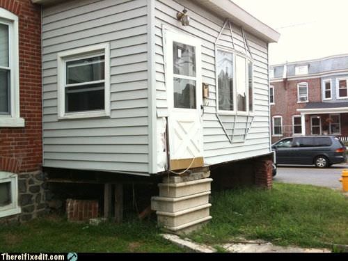

Hopefully an attorney is not selling it. He would probably sue for caling it out on the home inspection report.....You know it takes a structural engineer to report on that. :)
