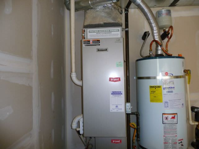

Robert Jones Posted October 3, 2009 Report Posted October 3, 2009 New construction, HE furnace located in the garage. Shouldn't the lower pvc pipe be run to the exterior? It did have suction while running, which to me, would be a no go due to the garage/carbon monoxide etc... Am I off base? Sorry for the sideways pic, was in a hurry. Click to Enlarge 60.67 KB Click to Enlarge 43.32 KB Click to Enlarge 34.48 KB

Terence McCann Posted October 4, 2009 Report Posted October 4, 2009 CO is not the problem - enough combustion air is however. You have a hot water tank and a gas fired furnace in the garage and both of them are pulling combustion air from the garage. Unless it is one huge garage or they have brought in makeup air from someplace you will be short on air. Did you notice makeup air anywhere? On a side note they can pipe combustion air, for the furnace, in from the outside which you already knew. When I installed my new 95% furnace this past spring I did not pipe in combustion air from the outside. Something about bringing in 0 degree air into a hot furnace didn't sit right.
Richard Moore Posted October 4, 2009 Report Posted October 4, 2009 http://www.docs.hvacpartners.com/idc/gr ... m05-56.pdf See page 4, figure 2. I really don't know why someone would prefer to install it that way over the 2 pipe system, but is is allowable as long as there is sufficient airflow for the combustion air. I wouldn't worry about CO from a car in the garage being used for combustion. It would be interesting to see what would happen with a car that had a fuel line leak, though. Why would it be any more of a concern than an regular 80+ furnace in a garage?

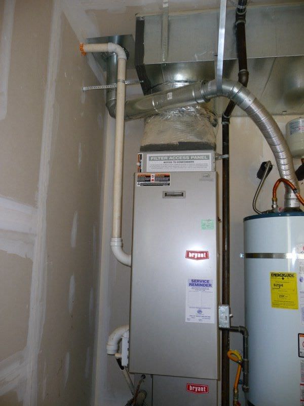

Robert Jones Posted October 4, 2009 Author Report Posted October 4, 2009 Hey Mike, Back to the furnace to be re-heated. I did not see any vents in the garage to let in fresh air. I can see I need to do a little research on these HE units. What caught my eye was the fact the lower pipe was not connected to the exterior, and as Terry mentioned, there is a gas water heater right there as well. I have added another pic, but it basically shows the same thing.

hausdok Posted October 4, 2009 Report Posted October 4, 2009 Hi, Terry, the 50 cf per 1,000 Btu's applies for indoor combustion air. If there are two vents to the exterior of the garage as you describe, then they need two net-free openings totaling 1sq. in. per 4,000 Btu (2407.6.1). If there is only one opening - which is the way it normally is around here - it needs to be within a foot of the ceiling, and the net free opening has to be not less than 1sq. in. per 3,000 Btu and has to be larger than the cross sectional area of the vent connectors (2407.6.2). ONE TEAM - ONE FIGHT!!! Mike
MechAcc Posted October 4, 2009 Report Posted October 4, 2009 350MAV Installation Instructions on page 22 left column at the bottom it states that the vent pipe and combustion air must terminate in the same atmosphere zone. Users Manual On page 4 left column of the User's Manual the following statement is included. "Your gas furnace uses air from outside the home for combustion and vents flue gas to the outdoors. It is not to be installed using in-house air. The vent and air-intake pipes must terminate outside the structure and must not be obstructed in any way. Do not block or obstruct air openings on furnace or spaces around the furnace." The combustion air pipe, according to the installation instruction for this furnace MUST be installed outside next to the vent pipe. Period. The furnace is incorrectly installed.
Robert Jones Posted October 4, 2009 Author Report Posted October 4, 2009 Thanks guys for the responses. So basically, there needs to be a net free opening in this garage within a foot of the ceiling. Does that sound about right? The water heater alone was 40k Btu.
hausdok Posted October 4, 2009 Report Posted October 4, 2009 350MAV Installation Instructions on page 22 left column at the bottom it states that the vent pipe and combustion air must terminate in the same atmosphere zone. Users Manual On page 4 left column of the User's Manual the following statement is included. "Your gas furnace uses air from outside the home for combustion and vents flue gas to the outdoors. It is not to be installed using in-house air. The vent and air-intake pipes must terminate outside the structure and must not be obstructed in any way. Do not block or obstruct air openings on furnace or spaces around the furnace." The combustion air pipe, according to the installation instruction for this furnace MUST be installed outside next to the vent pipe. Period. The furnace is incorrectly installed. I think you'd be right if it were a 350MAV furnace but I don't think it is. Builders around here usually go with a less expensive model. I think it's either a 340AAV, 350AAV, 352AAV, 353AAV or 355AAV series and those can be configured with either an outside intake or an inside intake. From the owner's manual: "Your new gas furnace may have been installed in 1 of 2 ways, as a direct--vent (2--pipe--Fig. 1) application or as a non--direct vent (1--pipe--Fig. 2) application. In a direct--vent (2--pipe) application, your furnace uses air from outside the home for combustion and vents flue gas to the outdoors. This type of application will have 2 pipes running from the furnace to the outdoors. (See Fig. 1.) In this application, the vent and air--intake pipes must terminate outside the structure and must not be obstructed in any way. Do not block or obstruct air openings on furnace or spaces around furnace. In a non--direct vent (1--pipe) application, your furnace uses air from adjacent to the furnace for combustion and vents flue gas to the outdoors. This type of application will have only 1 pipe running from the furnace to the outdoors. (See Fig. 2.) The other pipe will terminate in the same space as the furnace and is the source of combustion air for your furnace. Therefore, the furnace must not be enclosed in an airtight room or be sealed behind solid doors. It must have adequate airflow for efficient combustion and safe ventilation. Do not obstruct the combustion--air pipe in any way. The vent pipe must terminate outside the structure and must not be obstructed in any way. Do not block or obstruct air openings or space around furnace." Rob, Use Terry's method to determine whether you've got enough volume in that garage to meet the 50 cu. ft. per 1000 btu rule. If not, figure out what size intake opening you need through the wall of the garage to the exterior to meet the requirements for either one or two openings. Take the sum of the Btu/Hr input of both appliances, knock off the last 3 digits, divide by 3 and you'll have the size of the opening you need. Assume a loss of 25% net-free area for wire mesh, so you'll need to increase that by 1/3 to get your minimum allowable opening. Here's an example. Assume a 120,000 Btu/Hr furnace plus a 45,000 Btu/Hr water heater = 165,000 Total Btu hr. 165 divided by 3 = 55 sq. inches Assuming 75% net free for metal mesh you need a round opening of not less than 73.35 square inches. They don't make them in odd-sizes, so you'd have to use a 10 inch inlet. Or you can go with two openings. 165 divided by 4 = 41.25 sq. inches Assuming 75% net free for metal mesh, you need an opening of not less than 56 square inches. Divide that by two is two 28 square inch openings. Since a 6 inch duct has a cross-sectional area of 28 square inches you'd need two six inch ducts - one within a foot of the floor and one within a foot of the ceiling. WARNING: DO NOT TRUST MY MATH - DO YOUR OWN; I'M THE WORLD'S BIGGEST MATH MORON. ONE TEAM - ONE FIGHT!!! Mike

hausdok Posted October 4, 2009 Report Posted October 4, 2009 The users manual applies to the 340MAV No, it actually applies to the 340MAV, 350MAV, 352MAV, and355MAV models. It's academic at this point; it's a 340AAV and can therefore be configured with the intake inside the structure as long as the garage is of sufficient volume or has appropriately-sized intake openings directly from the outside. Most HVAC contractors around here install a single large inlet hood on the exterior wall but a few will use the other formula and install one vent through the wall and one vent with a duct to near the floor. ONE TEAM - ONE FIGHT!!! Mike

Jim Katen Posted October 4, 2009 Report Posted October 4, 2009 The users manual applies to the 340MAV The user's manual and the installation manual contain conflicting information. I'd tend to trust the installation manual with regard to this particular issue. As for combustion air issues, I've yet to see a garage in my area that didn't provide adequate combustion air. I don't know about other regions, but around here, we have large overhead doors on our garages with gaps large enough to throw a cat through. Installing combustion air vents in a garage here would be like installing vents in a screen door. - Jim Katen, Oregon
