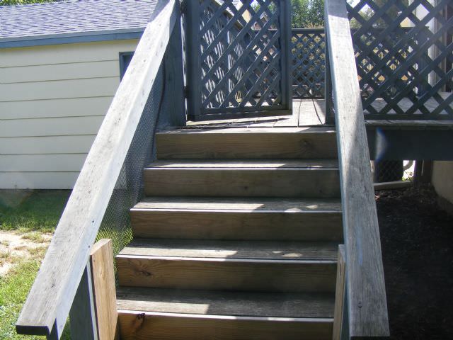

Jeff Beck Posted September 17, 2009 Report Posted September 17, 2009 I've never seen this before. This deck stair had a mesh netting on both sides of the stairs instead of balusters. There are a number of other things wrong with the deck but is this acceptable? Click to Enlarge 59.42 KB Sorry for the poor picture. It would appear to keep a toddler from falling through the space between the treads and the railing. but it doesn't add any structural support to the entire railing assembly like balusters would. Everything that I can find in my reference books deals with balusters. I'd appreciate any comments this. Thanks, Jeff Beck Foresight Inspection
Chad Fabry Posted September 17, 2009 Report Posted September 17, 2009 You were there. Is it a hazard? The entire stair set is a joke, why not just call it a safety hazard and recommend replacement of the assembly? It's inarguable.
Tom Raymond Posted September 17, 2009 Report Posted September 17, 2009 Uhm, is it really any different than the lattice on the guard rail? Or the raised ends of the deck boards being a trip hazard at the top of the stairs? Chad's right, but it doesn't end with the stair. That whole deck is toast. Tom
Jeff Beck Posted September 17, 2009 Author Report Posted September 17, 2009 No question that the deck is toast, I recommended that it be replaced from the ground up. As I said in the original post, I had never seen this before. Does anyone know if everything else was correct, that using a mesh netting is acceptable? Jeff
Chad Fabry Posted September 17, 2009 Report Posted September 17, 2009 Does it meet the intent of the code? Is it that robust?
Darren Posted September 17, 2009 Report Posted September 17, 2009 I would state the netting is not capable of withstanding 200 lbs of force; replace with another material capable of withstand the code requirement.

Jim Katen Posted September 18, 2009 Report Posted September 18, 2009 The netting is part of the "infill" area of the railing. As such, it has to be able to support a 50-pound load that's spread out across a 1 square foot area. I suppose that you could test it by cutting out a 12"x12" square of plywood, placing it against the net and pushing on it with 50 pounds of force. If the net deflects more than 1/240th of its span, then it doesn't meet the IRC requirements. The handrails in your picture aren't graspable. - Jim Katen, Oregon
Tom Raymond Posted September 18, 2009 Report Posted September 18, 2009 I still find it very amusing that everyone is focused on the netting and not the lattice. That stuff is only visually more robust, I'd bet the deflection is pretty close to equal. It'd be pretty easy to get to L/240 at a about a tenth the required load with either material. Tom
Jim Katen Posted September 18, 2009 Report Posted September 18, 2009 I still find it very amusing that everyone is focused on the netting and not the lattice. That stuff is only visually more robust, I'd bet the deflection is pretty close to equal. It'd be pretty easy to get to L/240 at a about a tenth the required load with either material. Tom Hey, the man asked about the netting. If I started picking on everything in every picture that people post, I'd run out of digital ink. - Jim Katen, Oregon
