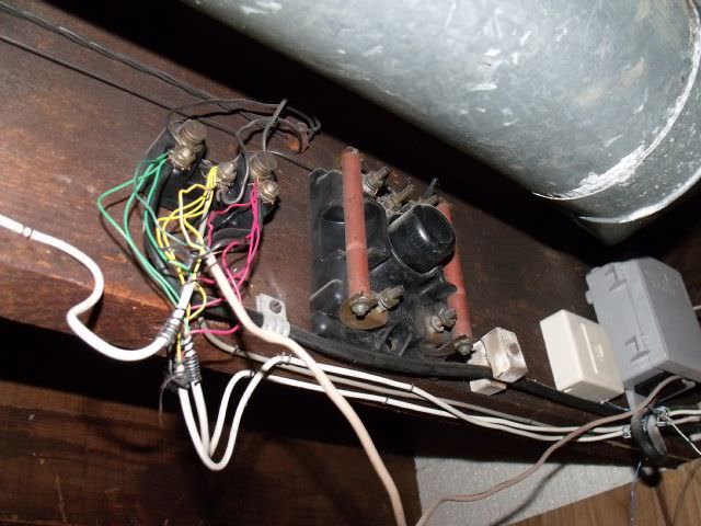

caryseidner Posted September 17, 2009 Report Posted September 17, 2009 Does anyone know what the heck this is? This is an 85 year old house, and the line was entering through an exterior wall, just above grade. I didn't know if it was safe to put my voltage sniffer on it, but I probably should have waved it close by to see if there was any voltage. What are the vertical copper electrodes all about? Click to Enlarge 55.42 KB Click to Enlarge 54.18 KB Click to Enlarge 36.58 KB
Bain Posted September 17, 2009 Report Posted September 17, 2009 Others will have more detailed explanations, but it's a transformer, or a precursor to the transformer. You see them connected to doorbell wiring in old houses.
Billy_Bob Posted September 17, 2009 Report Posted September 17, 2009 That looks like an old telephone surge protector... http://countryjoescollectiblestuff.com/ ... tning.html
Les Posted September 17, 2009 Report Posted September 17, 2009 it is a basic fuse, surge protector. not a transformer. for $16.50, I should start riipping them out of houses!

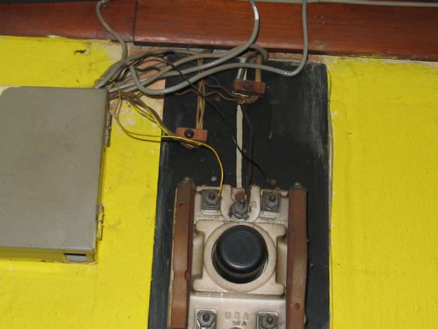

Brad Manor Posted September 18, 2009 Report Posted September 18, 2009 It's a surge protector for the old phone line. This one is in my own basement. Click to Enlarge 57.83 KB -Brad
Kyle Kubs Posted September 18, 2009 Report Posted September 18, 2009 Just in case there is still a little doubt running through your mind. It is part of the telephone system, or was. Though I was always under the impression it was some sort of filter, to clean up the signal. Definitely not a transformer.
Tom Corrigan Posted September 18, 2009 Report Posted September 18, 2009 That's an old phone company "protector". The orange tube is a fuse that was intended to go open. If you spin off the black cover in the middle you'll find "carbons". These are two assemblies consisting of a carbon blocks in a ceramic holder. The carbon block provides a ground path in the event of a high voltage hit. Go ahead, open it up and take a look! was a phone man in my pre college days. Tom Corrigan
Terence McCann Posted September 18, 2009 Report Posted September 18, 2009 From todays inspection. It's part of the phone system and I see them all the time in the older homes around here. Click to Enlarge 39.58 KB
