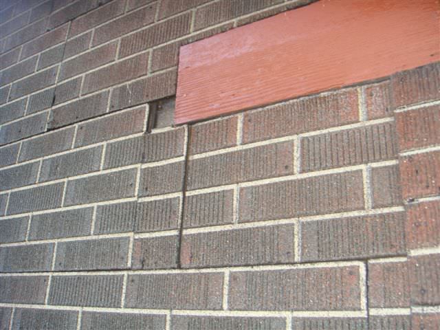

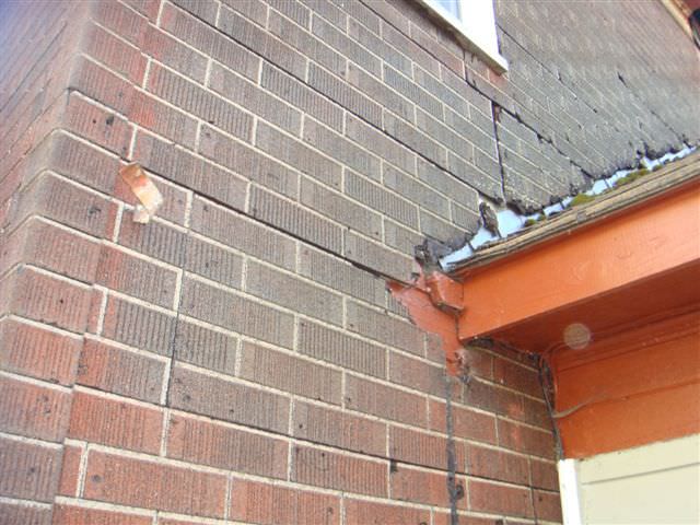

CHI Posted September 16, 2009 Report Posted September 16, 2009 Saw this on a 1912 home today. It appeared to be asphalt based product with a brick pattern. Any idea what to call it, other than old damaged everywhere? Click to Enlarge 71.46 KB Click to Enlarge 72.71 KB
tom struble Posted September 16, 2009 Report Posted September 16, 2009 around here its called anselbrick or insulbrick the name was usually printed on the back
waynesoper Posted September 16, 2009 Report Posted September 16, 2009 not much different than asphalt roofing but lasts longer due to the pitch, haha.
kurt Posted September 16, 2009 Report Posted September 16, 2009 Tom's right. I've called it insulbrick. It's like a celotex board imprinted with a pattern and some granule. It "works" largely due to the underlying siding providing the moisture barrier. Sort of an early rainscreen wall effect. It's always beat to hell around any fenestration, and there's usually chunks falling off in several locations.
CHI Posted September 17, 2009 Author Report Posted September 17, 2009 Thanks for the input. It was in good shape except for the damaged and missing pieces. What reamined was pretty sound. Was very much like composition roofing material and is lasting a long time.....thanks Wayne.

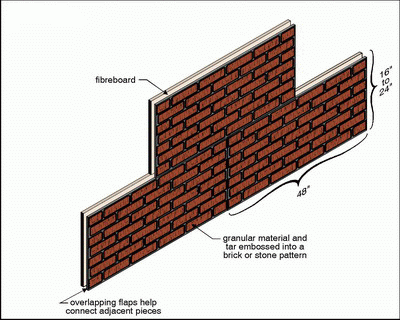

Bill Kibbel Posted September 17, 2009 Report Posted September 17, 2009 The correct spelling is Inselbrick®. We discussed this before here: https://www.inspectorsjournal.com/forum ... IC_ID=4873 Click to Enlarge 49.86 KB
