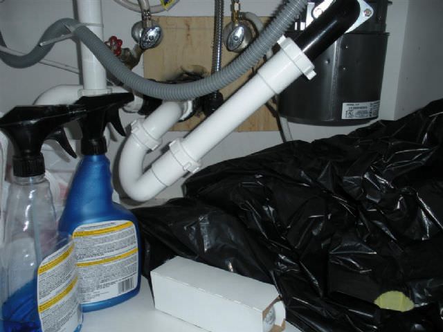

Disposal drain....
I think this will still function and I can't find anything that states otherwise (maybe you can).
This is a remodeled home and there were some other plumbing issues like the accordion drain pipes under sinks.

That looks like a double sink, it would only really need one trap, which would make the install cleaner.
Did you mention the lack of a high loop in the dishwasher drain to the disposal??

Thanks. The "loop" is up high as it passes through the cabinet.
They missed the clamp on the dw drain hose though.
