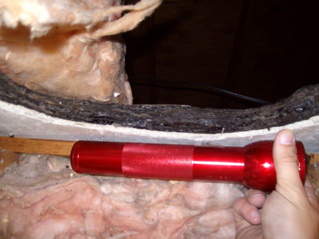

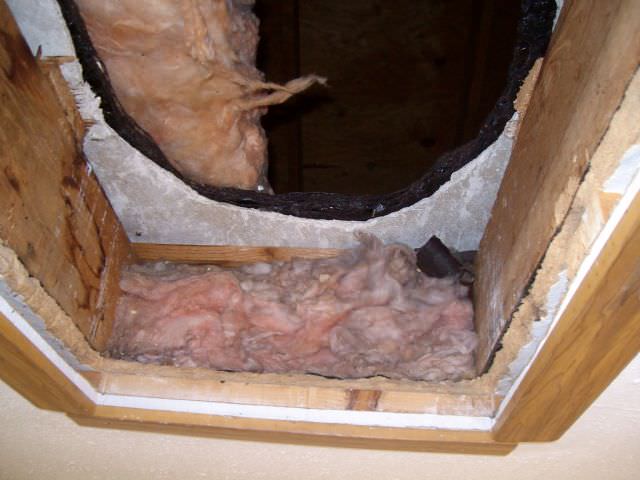

twendorff Posted September 9, 2009 Report Posted September 9, 2009 I did an inspection last week and when I opened the attic access panel (in the bedroom), I noticed that there was about 2"-2.5" of tarpaper (shown in the picture). When I entered the attic, there was fiberglass insulation in only about half of it. I have never seen this before and was wondering what the history may have been??? I wrote it up as improper material and inadequate insulation. Thoughts, ideas? Thanks. Click to Enlarge 50.76 KB Click to Enlarge 42.95 KB
twendorff Posted September 9, 2009 Author Report Posted September 9, 2009 Was it a converted garage? No, it's a 60 year old house that was originally very small with an attached garage. They converted the garage to a sunroom and added a dettached garage.
Bill Kibbel Posted September 9, 2009 Report Posted September 9, 2009 I'm not sure what you mean by "2"-2.5" of tarpaper". What I see in your picture reminds me of many buildings that I've inspected that originally had low-sloped roofs. After battling leaks for decades, they construct a new sloped-roof structure over the original. This creates a new attic space, with the old, built-up hot roof as the floor of the attic.
hausdok Posted September 9, 2009 Report Posted September 9, 2009 That's what it looks like; a BUR with a new roof framed over it and a hole cut in the old deck. OT - OF!!! M.
Tom Raymond Posted September 9, 2009 Report Posted September 9, 2009 Is it me or does that deck look like asbestos sheet? Tom
hausdok Posted September 9, 2009 Report Posted September 9, 2009 Might be. It wouldn't concern me; to inhale asbestos from that, you'd have to break off chunks, grind them up into powder and then snort the stuff. That's a lot of effort to go to in order to kill oneself. You'd probably breath more asbestos fiber driving down the interstate on a dry dusty day than you'd inhale there in 100 years. ONE TEAM - ONE FIGHT!!! Mike
