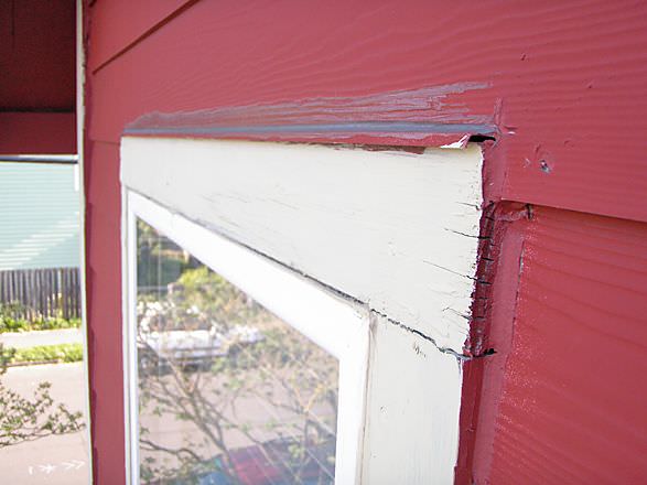

Ken Meyer Posted May 12, 2012 Report Posted May 12, 2012 Thanks Brandon and Patt, I was able to find the 2000 and 2005 instructions, but nothing older. The 2000 does not show the uncaulked gap. What made me wonder is that above the windows in the photos you can see the gap, but it has been re caulked by the homeowner. Other windows on the house look like they have original caulk, or at least someone did a neater job. There are 2 west facing second story windows that had problems likely from weather exposure; rain and baking late afternoon sun, and from lack of maintenance. The fix that was done on both windows was a heavy application of caulk, including covering the weep holes for good measure. There was some rot on vertical trim, I scanned the interior wall adjacent to one of the windows with a moisture meter but didn't find anything. The other room had a bed blocking the window. So my question is: what would your recommendation be for caulking above these windows when repairs are done; leave the gap above the windows uncaulked as current installation instructions say, or follow the guidelines from when the siding was originally installed? Click to Enlarge 36.03 KB Click to Enlarge 43.53 KB Click to Enlarge 42.54 KB
Brandon Whitmore Posted May 13, 2012 Author Report Posted May 13, 2012 The flashing is run short at the ends and to make matters worse, it appears to slope back towards the wall. I'd recommend opening the weep holes back up and caulking the heck out of everything. I'd be hesitant to recommend the removal of caulk when it may be all that is keeping the water out of the wall.....
hausdok Posted May 13, 2012 Report Posted May 13, 2012 You can see the outline of the upleg of the head flashing on the siding above the window where the paint is peeling. Since I've never seen that with HP before, I suspect that it doesn't extend behind the WRB behind the siding. If it doesn't extend behind the WRB, it wasn't working anyway and caulking the gap probably didn't help much and didn't make it any worse. ONE TEAM - ONE FIGHT!!! Mike
